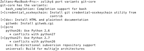

What do the plus signs mean? [+]doc, [+]pcre
Are they already enabled by default?

Those are variants and they are not enabled by default. Macports and homebrew will download the source, configure it and then compile it. You can set various options and to keep things simple Macports uses this variants system. If you want to have git with only the documentation you'd enter the following:
Code:
sudo port install git-core +doc
It should also work the other way around. This helps if you do not want something like X11 (graphical environment). You could do something like this:
Code:
sudo port install wireshark -x11
. Alternatively you could use +nox11, it does the same thing. If you want to do this as default behaviour for any port you install you should set this in the file /opt/local/etc/macports/variants.conf (it has some examples in it).
Usually the defaults are fine. You only need to use variants when the default doesn't work because it lacks some feature. Things like documentation can be left out as most software will have it posted on the internet and you can search for it (you get examples from others and such).
Be sure to check out the Macport documentation regarding variants for more info and some examples: Port Variants.
