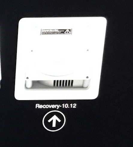

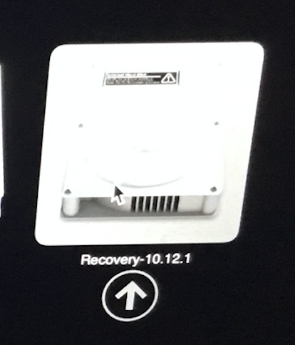

Here are before and after photos:
Before:
After:

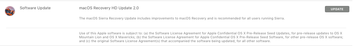

Look what apple put in my mac app store on one of my other computers:
After installing, it updated the recovery partition to a 10.12.1 version.
Not everyone can get this in the mac app store, and then they can do it using the method in my first post instead.
But clearly this demonstrates that apple want us to update the recovery partition to a 10.12.1 version.
I am not seeing that update available. If Apple thought we all needed it, it would be available to all users.
I have only seen that update on betas before. What OS version are you seeing that update in and have you run betas, which would explain why you are seeing it.
