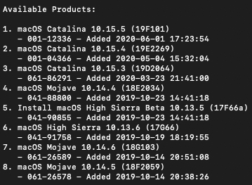

At this moment, you can get 10.15.5 (19F101), 10.15.4 (19E2269) and 10.15.3 (19D2064) with https://github.com/corpnewt/gibMacOS

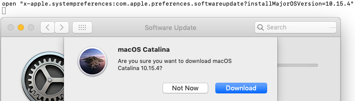

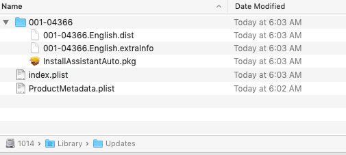

I just checked, 10.15.3 and 10.15.4 are not available.
They are, search for 061-86291 (10.15.3) and 001-04366 (10.15.4) in Apple's update catalog

No, they are not. They can be downloaded from Mojave and presumably from Catalina 10.15.0, 10.15.1 and 10.15.2.
Regardless of their ability to be downloaded, 19D2064 is the forked build of 10.15.3 for the 2020 MacBook Air, and 19E2269 is the forked build of 10.15.4 for the 2020 MacBook Pro 13" models. You can tell they're forks because of the 4 digits in the build number. The standard release version of 10.15.3 is 19D76 and 10.15.4 is either 19E266 or 19E287 (after the supplemental update is installed.)
