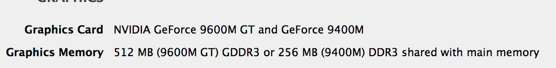

Current memory: 2 x 2GB 1067 MHz DDR3
I also want to update the graphics card I think. On the Adobe website they have various recommendations of optimal graphics cards but I have no idea what my Mac could handle or be compatible with.
Current graphics card: NVIDIA GeForce 9400M 256 MB
(In 'About this Mac', it lists another graphics card 'NVIDIA GeForce 9600M GT 512 MB - I'm not sure what this means and how these work together)
The graphics card can't be replaced.
You have the 9400M which is the chipset and you have the discrete 9600M GT 512MB.
The OS switches the card depending on what you do.
For example, when you are browsing the web you use the 9400M. When you fire up a game or a graphic intense app, the OS will switch to the discrete card

You can't upgrade your graphics card but you actually have 2 video cards in your computer.

Ok so can I check: Am I limited to 512Mb or do they work in tandem? I am a bit confused as to whether I have enough power to run Adobe Premiere Pro Creative Cloud. They are recommending 1GB as optimal (but not essential)

They are not working in tandem.
Unfortunately, you are limited to 256MB on the 9400M and 512MB on the 9600M GT.
The 9600M GT is a good chip, but it's so..2009 😀.
When you run Adobe Premiere the OS will switch to the discrete graphics.
