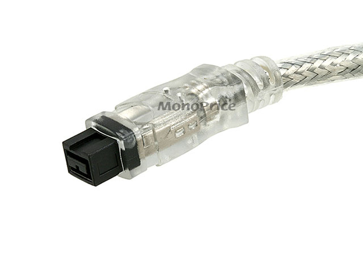

I was looking at the 6-pin/9-pin, the part that connects to the camcorder does not look like the one I need. The 6-pin/9-pin looked like this:

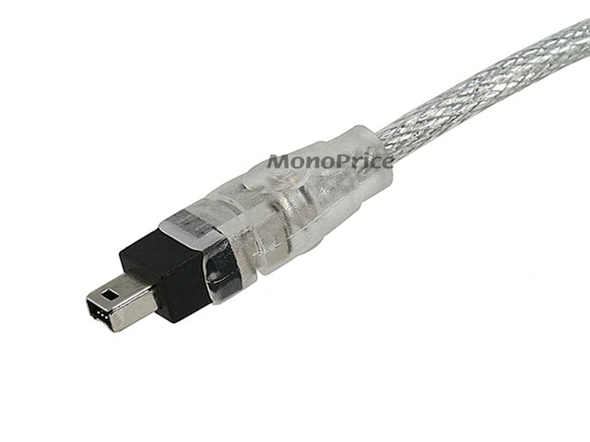

I needed one that looked like this:
If one end fits the camcorder and the other end doesn't fit your MBP, you need a FW400 -> FW800 adapter. Like this one. One of the reviewers has the same problem as you. I had the same problem connecting a new iMac (FW800) to an existing DVCAM deck (4 pin FW400). PITA.

Yeah, it's odd that monoprice doesn't have a 4-pin/9-pin cable. If they did, it would save you an adapter.
I'm sure the 4-pin/6-pin cable you got at walmart would be fine if you add a 6-pin/9-pin adapter.
The 4-pin end would connect to your miniDV and the 6-pin end would connect to the adapter. FW800 is 9-pin, so the adapter would connect to your MBP.
The adapter that martinX linked should work, but on that same page is a 4-pin/9-pin cable. LINK
This would work better and be cheaper to boot.
