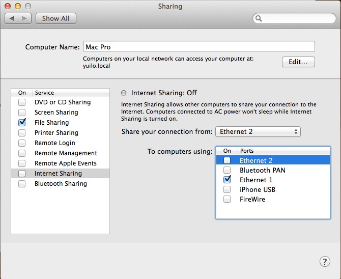

I don't have TBD, can't tell, but for the Ethernet port, that should be very simple.
In system preferences, go to sharing, turn on internet sharing. And then choose the internet source, also which port you want to share.
It seems you've already try this, which part not work?

When I use "Internet Sharing" the laptop only gets internet. It is not connected to the network, but rather a small unique network is created between the nMP and the laptop, giving access to internet and nothing else - the laptop even gets an IP address different from what my DHCP server is handing out.
This happens/works whether I use the TBD or the 2nd port on the nMP.
If there was a "Network Sharing" option in addition to the "Internet Sharing" one in "Sharing" preferences, that would probably do what I need...
So, you want to connect your laptop to the Mac Pro's intranet (local network), right?
In this case, I believe that you need the server app. It's a pay apps from the Appstore, it can make your Mac Pro work as a DCHP server to provide IP to another computer to access your local network. Since it's a pay function from Apple, I doubt if there is a way to achieve the same thing without any 3rd party software.
The Mac Pro should NOT provide DHCP services, my router is already doing just that. The Mac Pro should ONLY work as a dumb switch. It is much more to provide Internet, and it does that well. When it provides Internet Sharing it is working as a DHCP service, creating a subnet. I just need it to give access to an existing network.

In the other thread I focused on getting this to work with the TBD. That I have given up on, and now I am trying to get this working via the nMP. What you are saying is that it is not possible to connect to the Network via the 2nd port in the nMP either. That is very disappointing, and I think Apple is wrong is preventing this. I do say preventing, as it is not technically difficult - it is more work to allow for internet sharing that letting the nMP work as a switch.
I'll try the bridge method. Is the reversal just rebooting?
