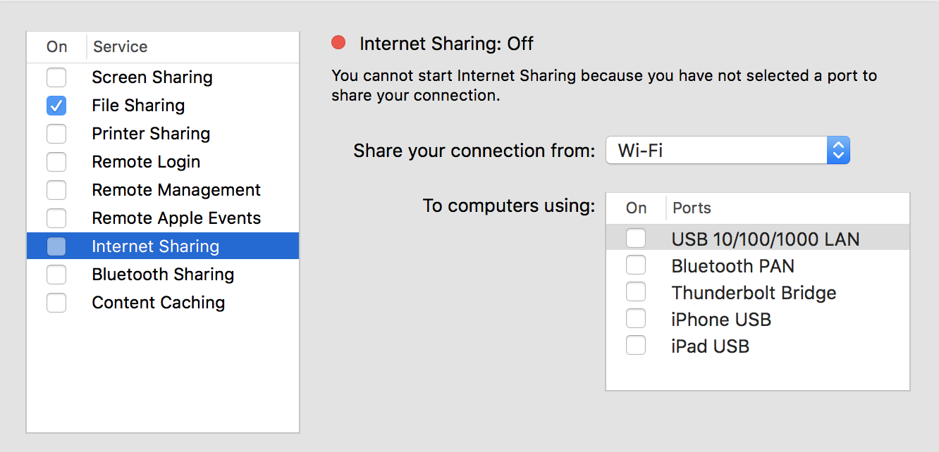

Hi all, I was trying to set up my Mac as a hot spot, but I am unable to. I went to System Preferences/Sharing. As you can see by the image below, there is no port selection on the right side "WiFi" so that computers using wifi can see my Mac as a hotspot. As the message states I cannot select "Internet Sharing" on the left side because of this. (This is how it seems it is supposed to work.) I have not found anything to help me with this, what am I doing wrong?
You have to share via a different connection method to what you're connecting to the internet with. So, for example, you could share from USB to Wi-Fi, or from Wi-Fi to Ethernet, but not from Wi-Fi to Wi-Fi.

Yes I can select those, but I don't need them - I want computers to access via their WiFi yet that entry does not show up like it seems to in the instructions on how to set this up. Something must be preventing it as an option.

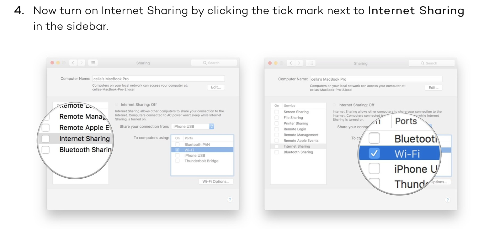

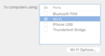

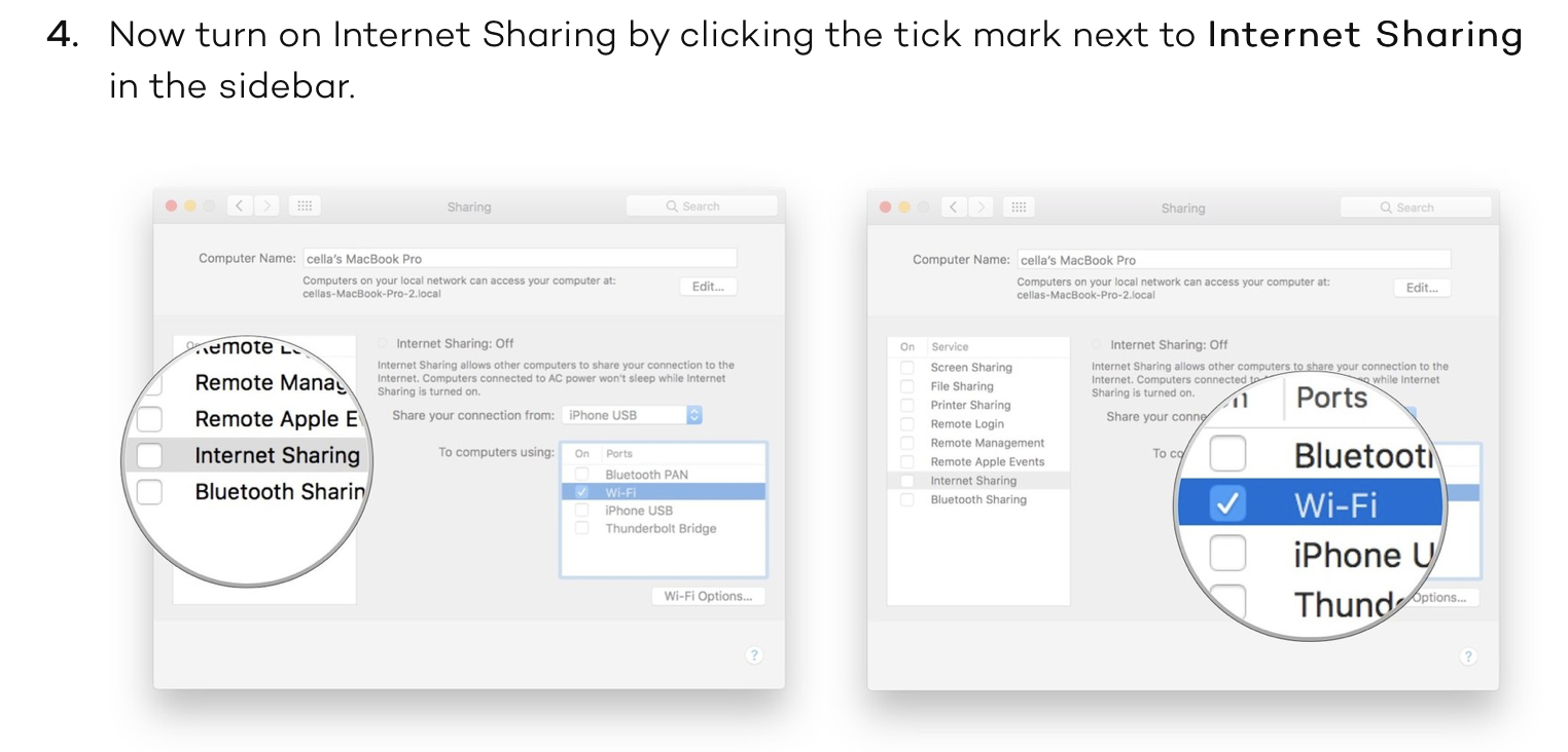

Really? I am referring to this screen, it is on a Mac not an iPhone - I do not see the WiFi entry on the right side:
Yes really. Look again at that picture. It says, “Share your connection from iPhone USB to computers using WiFi.”
