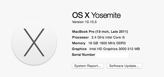

Hi All,
I want to be able to have my MBP running when I close the lid.
I have gone into System Preferences and in the Energy Saver option, I have selected 'never' in Computer sleep.
I am asking because, if I have a download/torrent going on and I close the lid, the download/torrent stops.
The MBP springs back to life once I lift the lid again, but I can see that the torrent was stopped in the time the lid was closed.
I have attached a screen shot of my MBP specs.
Thanks in Advance for the replies.
