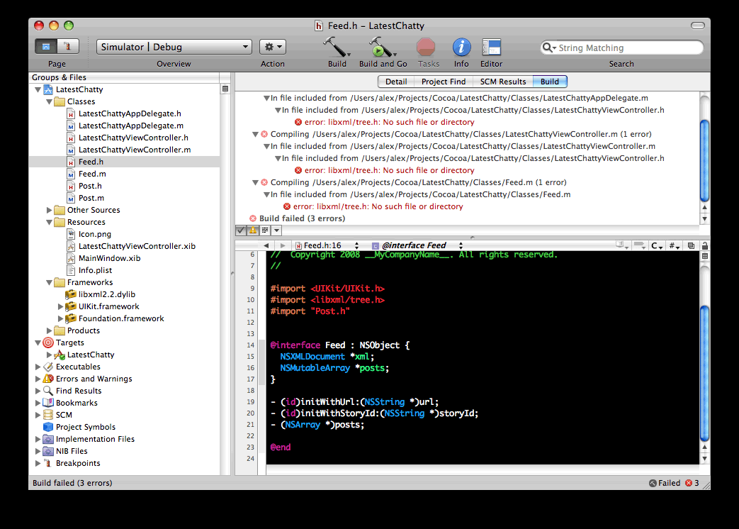

I haven't yet tried TouchXML, but have you tried directly adding /Developer/Platforms/iPhoneOS.platform/Developer/SDKs/iPhoneOS2.0.sdk/usr/lib/libxml2.2.dylib to the resources folder in your XCode project? Does that help? I have to do the same thing when using SQLite (libsqlite3.0.dylib) and other external libraries to my project.
Still got nowhere 🙁
My Objective_C noobness is showing, I'm sure.
In the iphone SDK libxml is in /usr/include/libxml2 so you'll have to either find a way to add that to the search path or change the #include lines to stick the libxml2/ in the front.
That's a big library to pull in though if you just want to parse an HTML page (which doesn't conform to XML standards anyway so probably won't load into the parser in the first place). You'd be better off just searching for the bit of page you want and parsing it directly IMO.
I'm a complete retard. When I added the search path, I was adding it the "Release" configuration, not the debug config. I didn't realize they were separate.
It found libxml now and I can use TouchXML it seems.
Thanks for the help ful posts anyway, they expanded my education a bit 🙂
