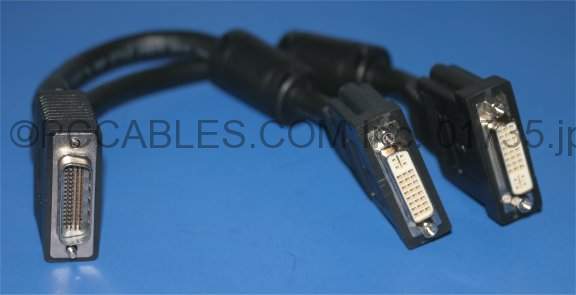

How about this dvi cable right here:
Unfortunately you either need to cough up the cash or go without. That cable will not work. Firstly, any DVI splitter will require a dual-link DVI, http://store.apple.com/uk/product/MB571Z/A?mco=MTY3ODQ5OTY which will cost a considerable amount to not even work properly. Once you were to use that, you'll have the further problem of needing to have identical screen resolutions capable on both monitors. Thirdly, the Mac won't be able to understand they're seperate monitors and will treat them as one, causing all sorts of problems with applications. In all, that cheap solution is worthless and would create an experience that no one should have to endure.
