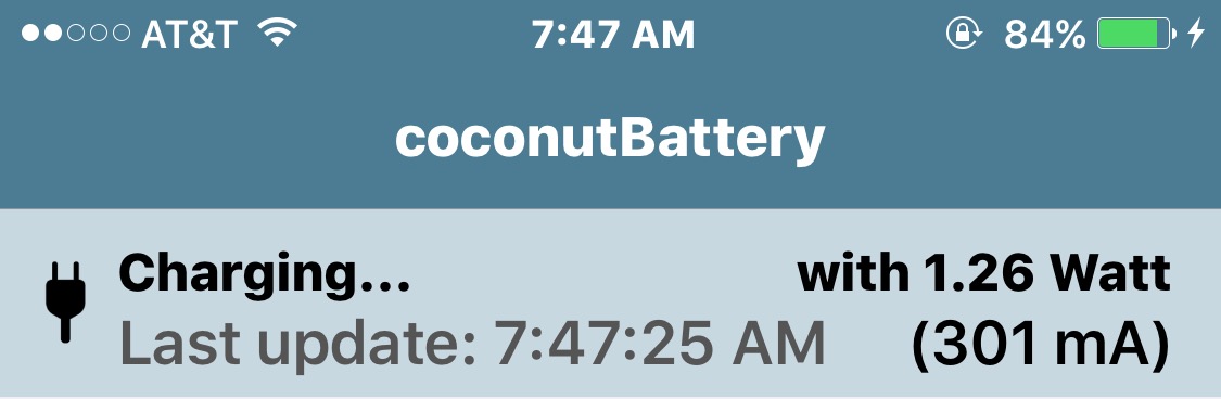

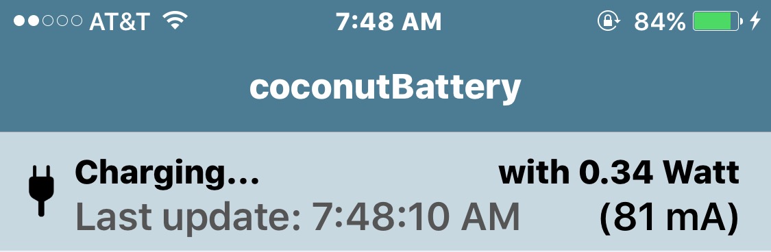

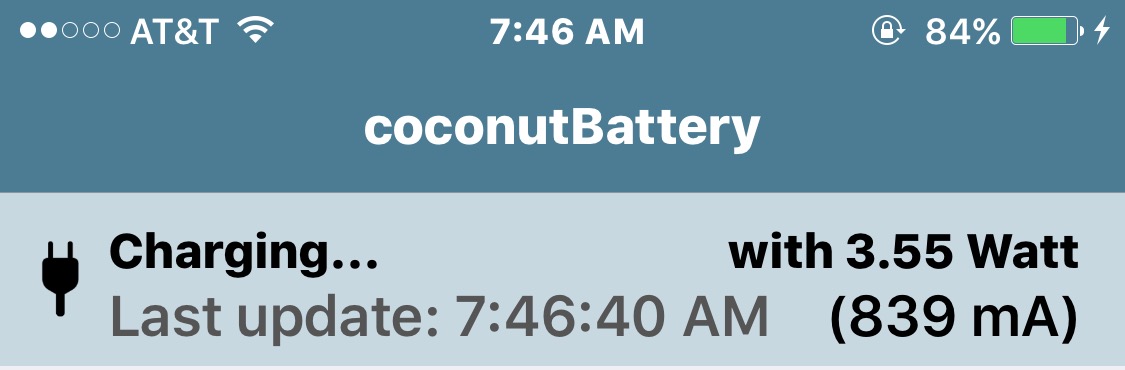

A USB extension cable will lower the current flowing into the iphone battery due to the increased resistance of the cable. The current is reduced, not the voltage.
The length of the cable determines what the charge rate will be. The longer the cable, the less current will flow. This allows much gentler trickle charging when using the phone while plugged in and when not in a hurry to charge. Lower charging rates keep the battery cooler while charging and put less stress on it.
A 5ft USB extension cable will effectively cut the charge rate of the standard iPhone charger (3.55 watts) by 65% to 1.26 watt. Two of them (10 ft) will trickle charge the battery at 10% of the normal rate at 0.34 watts.

Standard iPhone wall charger alone:
with 5 ft USB cable
with two 5 ft USB cables connected together.

FYI: this is rubbish. You are infact hurting your battery more. Read this: http://goughlui.com/2014/10/01/usb-cable-resistance-why-your-phonetablet-might-be-charging-slow/
You're creating a sub-normal voltage at the phone end. the trickle charge ends up not charging much at all and you have more power loss. The link gives detailed numbers.

The link posted above proves my point exactly. Longer cables slow down the charge rate. That's the whole point. Trickle charging is better for all batteries, including Lithium iron phosphate batteries used in iPhone.
