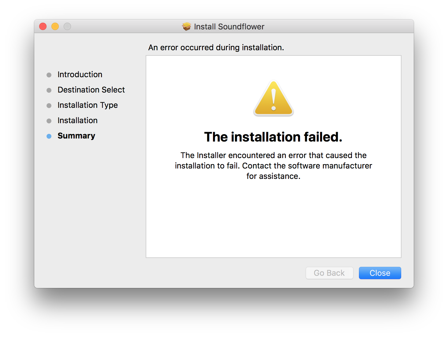

I’m not definite on this, but it looks like you missed step 3. You have to open the package using the control key, otherwise macOS won’t allow it to complete installation.
I thought I did that the first time, but just to be sure I tried again, and it did not work for me. ): (I did run the uninstall script first to see if that would help, but it did not. Perhaps I'll try a restart to see if, after that, it will work.

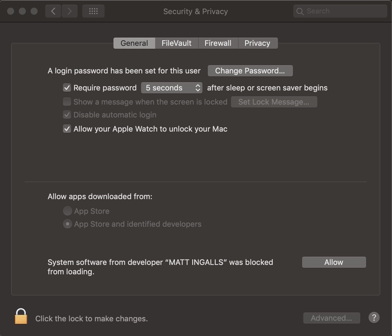

If your install fails, it's likely due to a security protection block by your Mac.
To fix:
1. Make sure System Preferences is *not* open (otherwise this may not work. You can start over if you miss this step).
2. Run the installer.
3. When you get to the last step that says "The Installation has failed", leave this window open (important).
4. Now open system preferences. Go to "Security & Privacy" and under the first tab you should see a new message at the bottom saying: 'System software from developer "MATT INGALLS" was blocked from loading.'. Click "Allow" (the message will now disappear). - see screenshot below.
5. Close System Preferences. Close the failed installer window.
6. Re-run the installer.
All should work as expected now. Enjoy.
