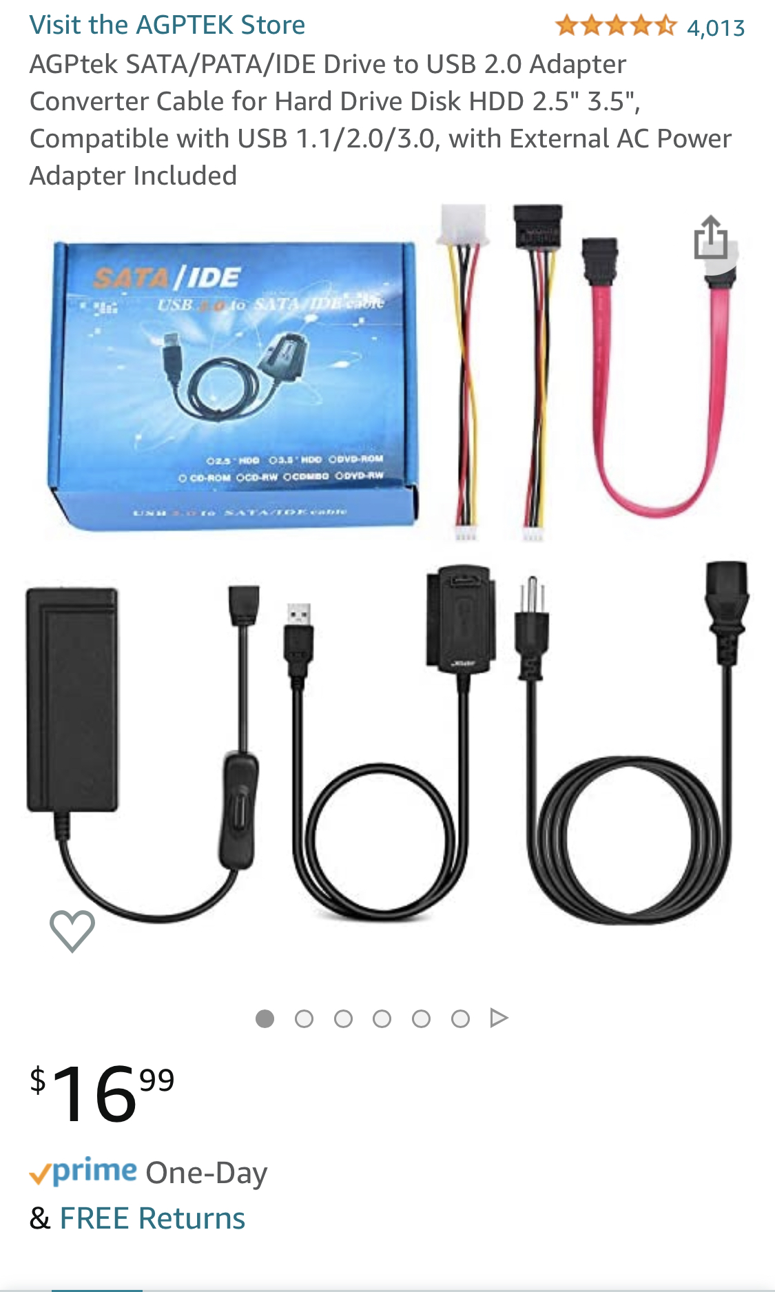

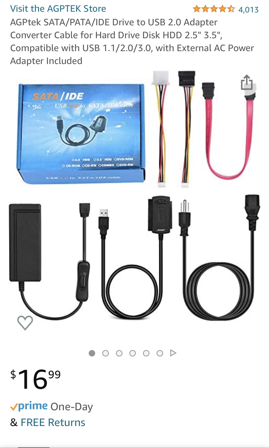

Buy this from Amazon. Connect the power adapter and the appropriate connector to the removed HD. Plug in the USB into a modern Mac (a windows machine won’t be able to read a Mac formatted drive). The old drive should mount and behave like any external drive (assuming it’s still functional).
Reactions: Boyd01
View attachment 1977240Buy this from Amazon. Connect the power adapter and the appropriate connector to the removed HD. Plug in the USB into a modern Mac (a windows machine won’t be able to read a Mac formatted drive). The old drive should mount and behave like any external drive (assuming it’s still functional).
Nice kit, but you would still need an adapter for the 50-pin SCSI hard drive.
Yikes, some of those adapters are going for $350 on eBay. While we're at is that the only solution for connecting a Zip drive to a current Mac?
