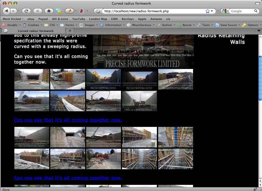

Here is live: http://www.preciseformwork.co.uk/new/radius%20formwork.php
Thanks for all your input people. Angelwatt, that's pretty impressive - what I would like to do is enter custom certain different bits of information at different times. What I'd like is to perform different actions each time e.g. a certain paragraph about something, then a different paragraph about something else. Possibly even insert a movie and another paragraph.
At the moment every 10th item is performing the same action, it also performs it at the start, displaying the paragraph before my loop begins.
I also have another problem - I need to create a condition that will not display a directory, or only to display jpegs. As one of the directorys is being displayed and it makes it look like there are only 9 in that row and makes it look messy.
This is clever stuff, well beyond my capabilites 😱😱. So interesting though, can see how I'm becoming addicted 🙂.

The problem is in designguy79's addition to the code.
PHP:
$i++ % 10 == 0 && $i!=0
In this code the $i++ is a post increment. That means that the $i % 10 code is evaluated and then the $i is incremented. For example, if $i is 10 it evaluates 10 % 10 which returns a 0 and then $i is increased by one to 11.
The problem is that designguy79's code is checking if $i is 10. The solution is to adjust the if statement to check when $i is 11.
PHP:
    // For every tenth iteration, do something special - skip the first one
    if ($i++ % 10 == 0 && $i!=0)
        if($i==11)
echo "<p> This is the photo's of the way it was done.</p>";
        elseif($i==21)
                       // do what you want for the second one
        else
                       // a "default" action if none of the above match
Alternatively you could change the initial if clause to a pre increment:
PHP:
++$i % 10 == 0 && $i!=0
The problem with doing that is that the paragraph will then show up after the 9th image. The solution is to set $i = -1 instead of 0 initially.
You also need to change .DS_sStore to .DS_Store .
A good way to solve problems like this is to print out all the variable to see what they're doing. Instead of outputting the images have it output the $i value, the value of $i % 10, and the file name. That way you can really see what's happening.
EDIT: And just to show you that there's often more than one way to skin a cat here's the way I would have done it:

Thanks panoz, that inserts the paragraphs where I want them. Unfortunately the thumbnails are now in a vertical list. How do I get them to display inline?🙂
Use CSS!
PHP:
.thumbs{display: inline;}
This will cause the images to appear in rows as wide as the container they are in, in this case the paragraph which may actually be as wide as the browser window.
If you want to limit this to say four images at most on a row then you will need another condition to output the closing tag and open another paragraph.
Thanks for that suggestion Dunmail, I've tried it out in my css file and it does not work.
The php code must be creating something, as they were flowing inline before so gotta be something with the php 😕.
They're showing up vertically because you're inserting a br tag with the linked image, which will make them go to the next line. Images are already inline elements so using CSS to make them inline is unnecessary.
