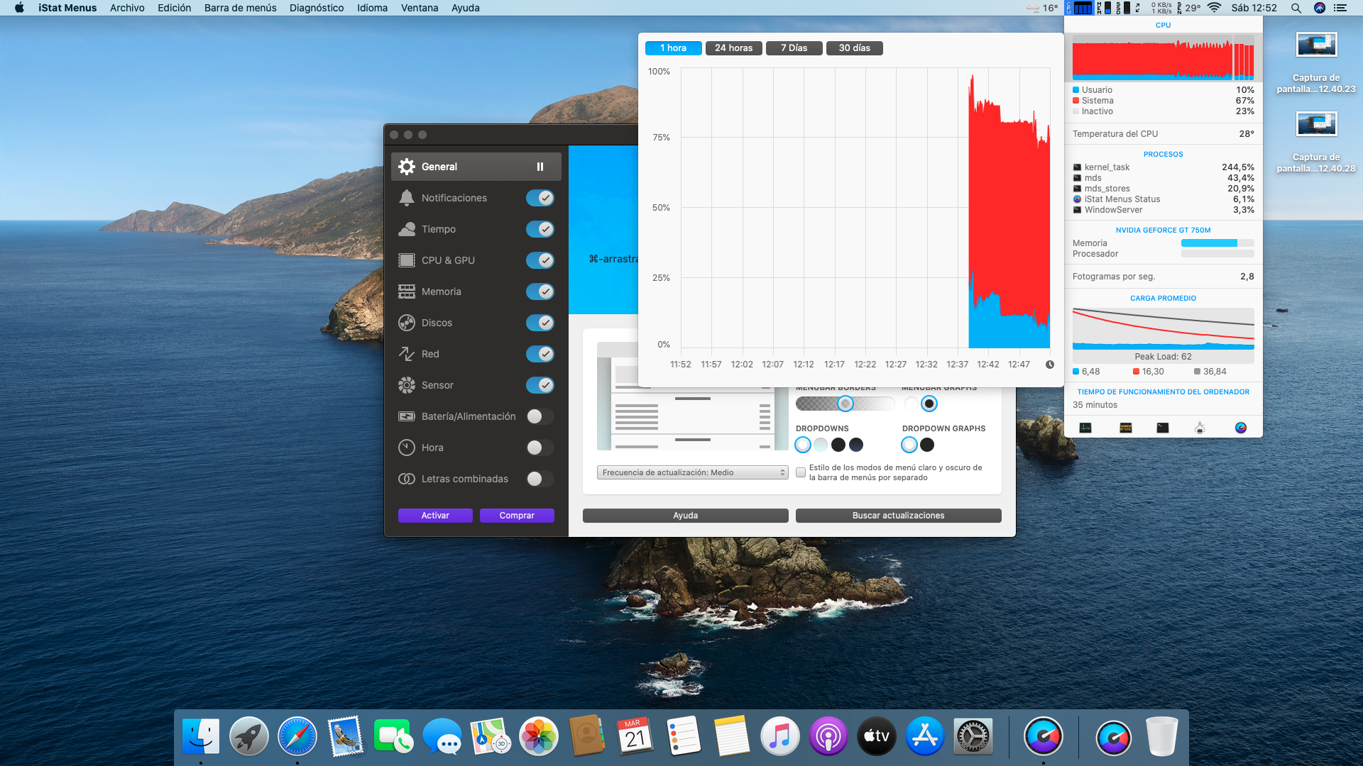

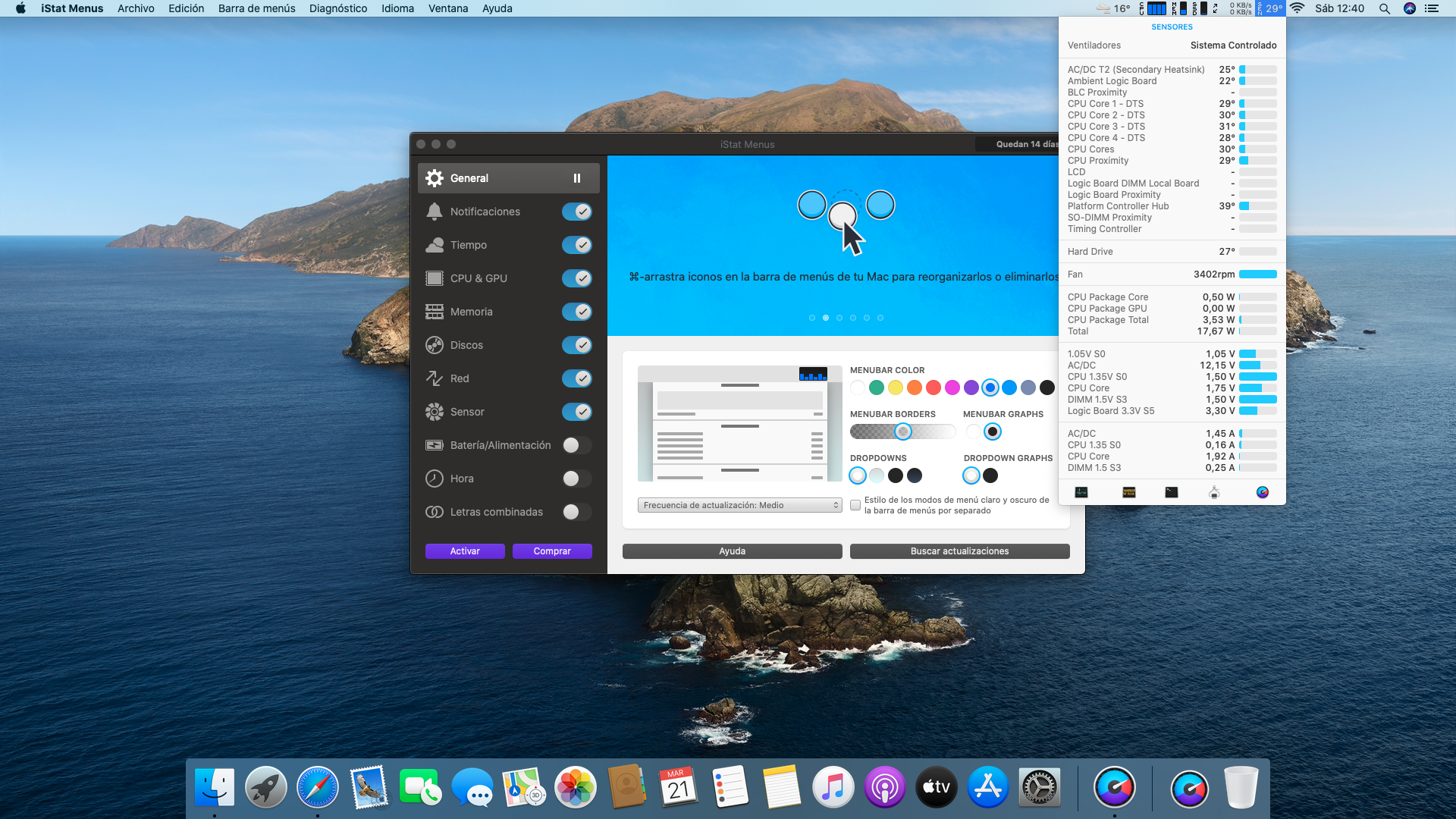

Hi to all, I have a iMac late 2013 21,5" with de screen broken, the main board not detect screen and fan is full speed and system work very slow. I want use as Mac mini connect to monitor, any idea for resolve the screen issue?
Apple diagnostics show PFM006 and VFD001.
Thanks!!!

The reason why your fan is ramping is because you do not have the LCD temperature sensor connected to the machine - which runs through the LVDS/DP connector
