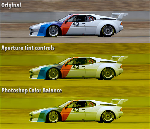

I'm with Yakamoto with the method: it's most likely color balance.
The sample below shows the original photo, then a version done in Apple's Aperture with the black and gray tint wheels slammed to yellow while the white tint wheel is slammed to blue. The last version is in Photoshop with a Color Balance adjustment layer. The Yellow/Blue slider is set to Yellow in the Shadows and Midtones, and left alone in Highlights.
