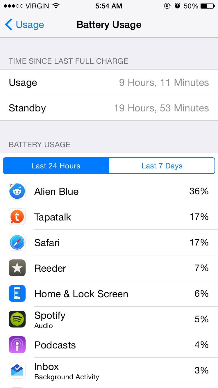

I feels the same, although I dont really have numbers to back it up because a respring, resets the usage tracker and I am always playing with new tweaks that need a respring
