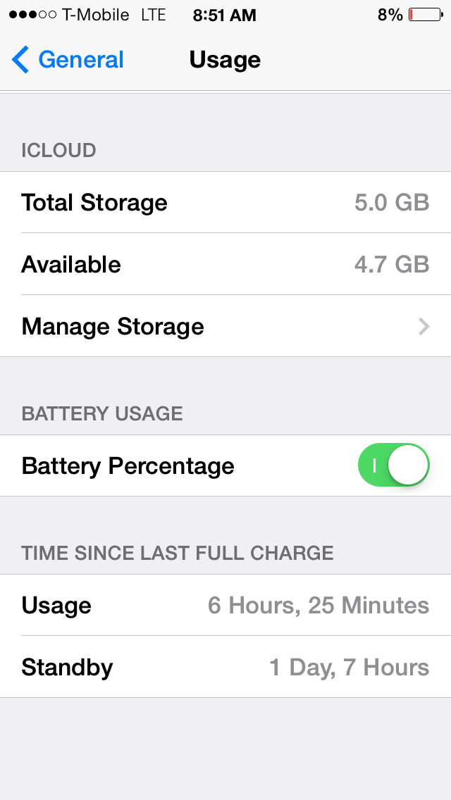

Here's mine. I keep LTE on 24/7 because it's that good here!
I've gone nearly two days between charges before with about the same usage.

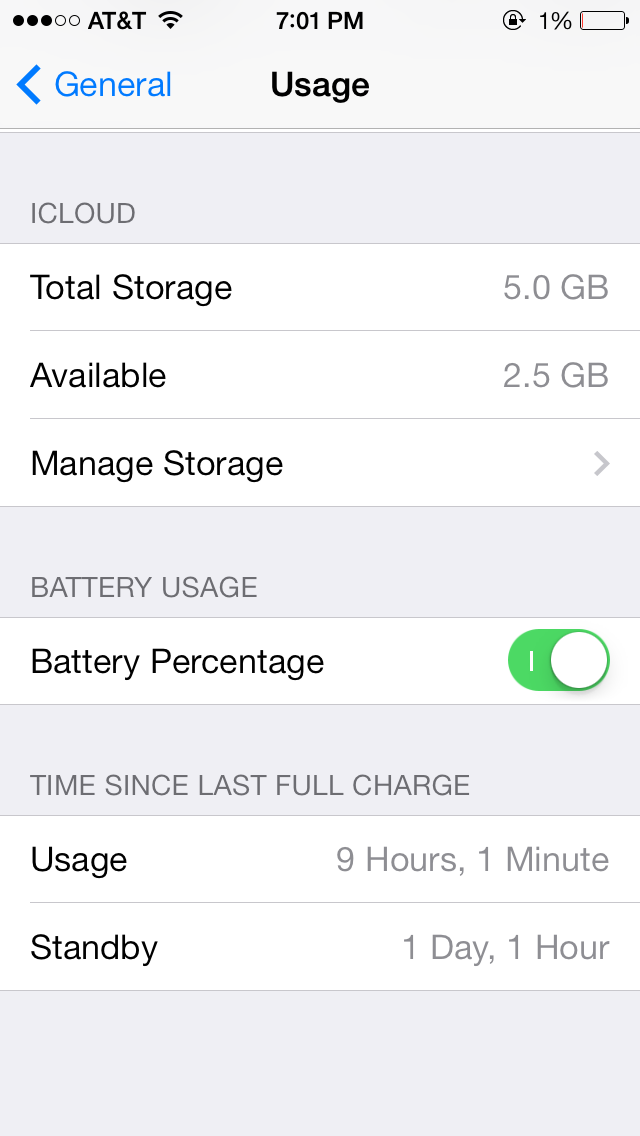

Hopefully they can help at the apple store tomorrow third trip in three weeks... So far I can't say I'm all too impressed.

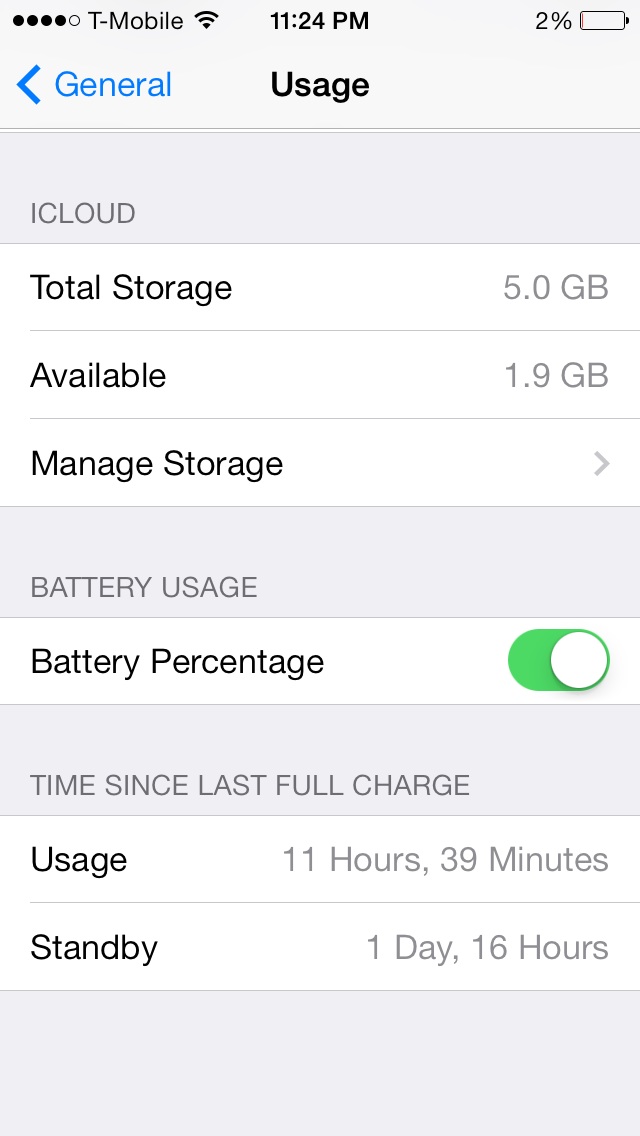

I'm quite happy with this batterylife. Didn't even bother to discharge it more before I plugged it in, plenty of juice left and with extremely heavy use.
I guess it helps to have 5 dots on the signal wherever I go too.
