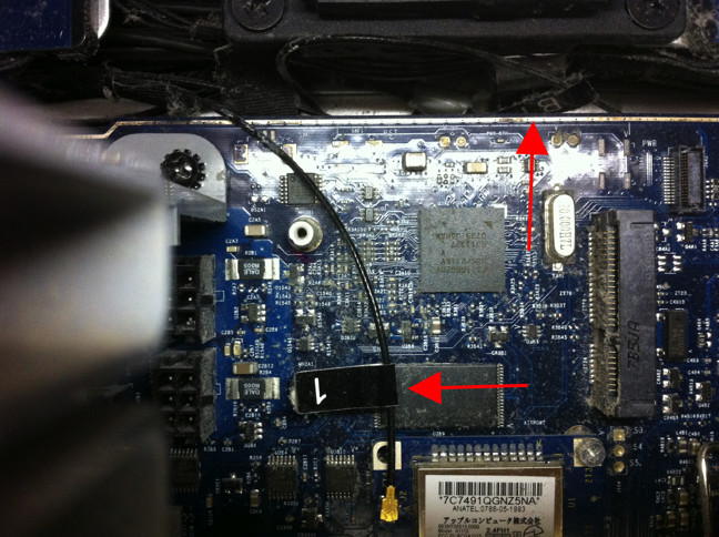

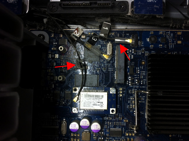

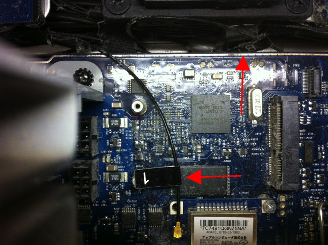

Anyhow, while doing the antenna cable swap I took pictures and decided to post them here as reference. My system does not have a wifi card so the internals and original wiring location looked slightly different than in the OP's photo.
Photo #1 the top arrow points to the bundle of unused antenna cables. You can see one of them has a '2' tag attached. The cables are almost hidden underneath the motherboard so might be easy to overlook. The bottom red arrow points to the factory-connected BT antenna cable.

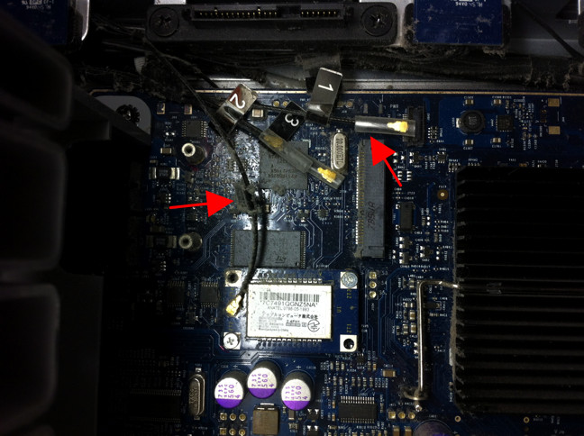

Photo #2 the top arrow points to the antenna bundle after I fished it out from behind the board. The bottom arrow again points to the BT cable --- the tag got twisted while fishing.

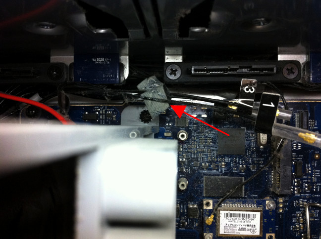

Photo #3 the arrow points to a piece of black tape that needs to be undone in order to separate the bundle of unused antenna wires. If you're careful you can re-use it to bundle up again when the swap is finished.
Tip: be patient when removing and attaching cables to the BT card, and be sure to use an appropriate tool (spudger or similar).

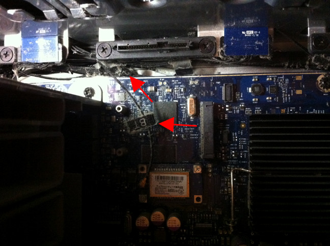

Photo #4 the top arrow shows where I tucked the rebundled unused antenna cables. The bottom arrow shows the '1' antenna now attached to the BT card.
