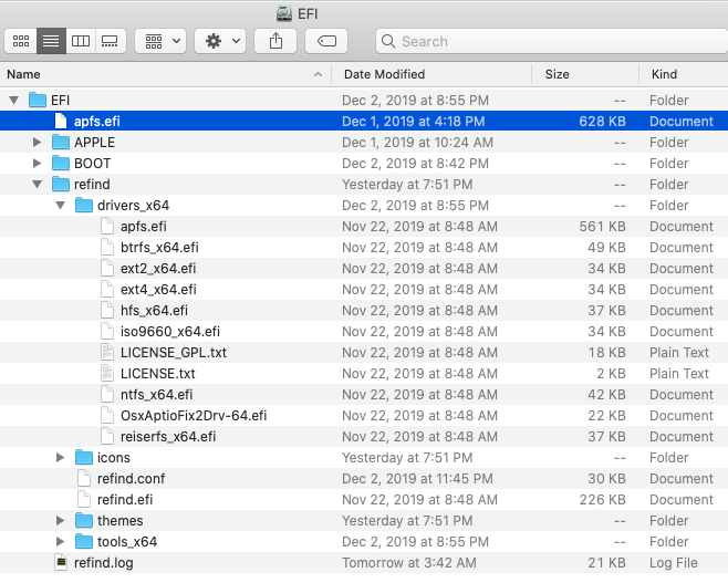

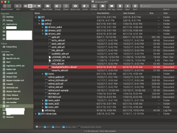

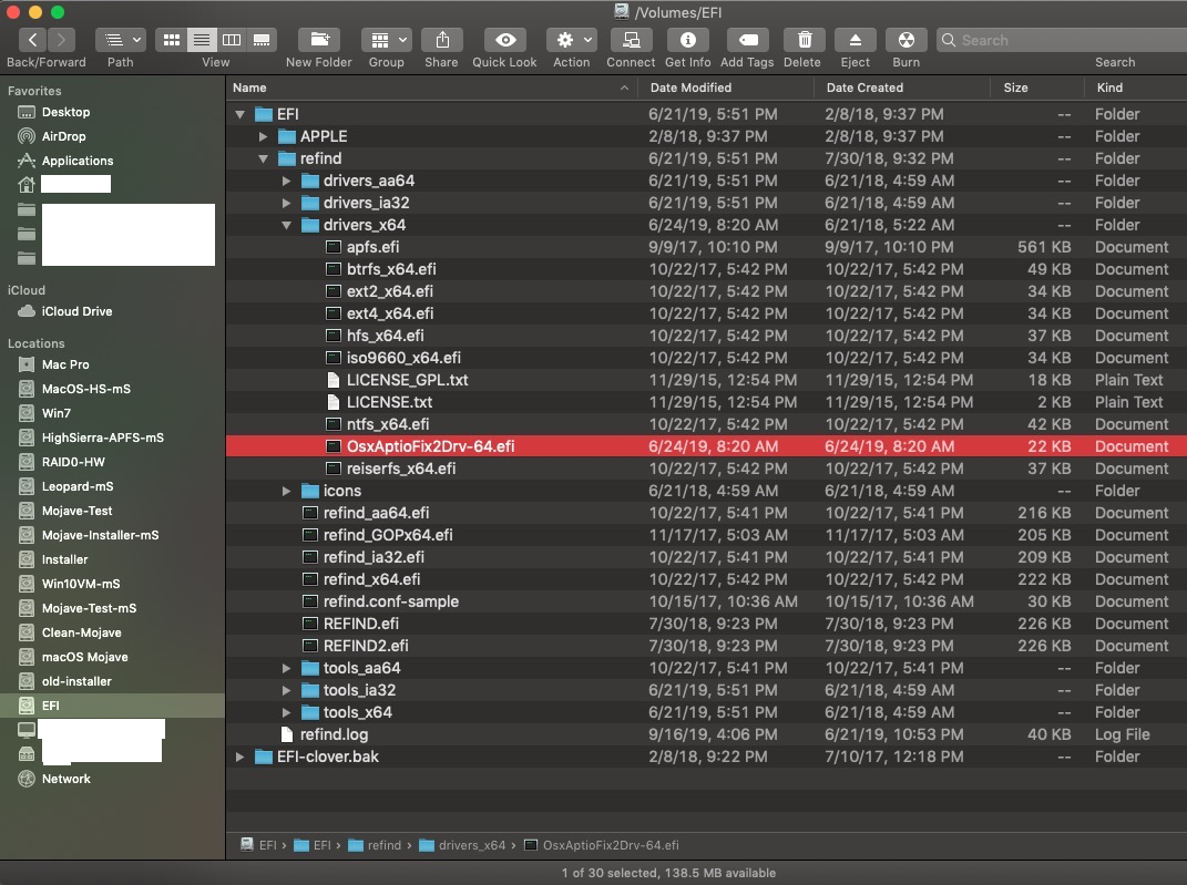

If you open Finder you should now see something like this:

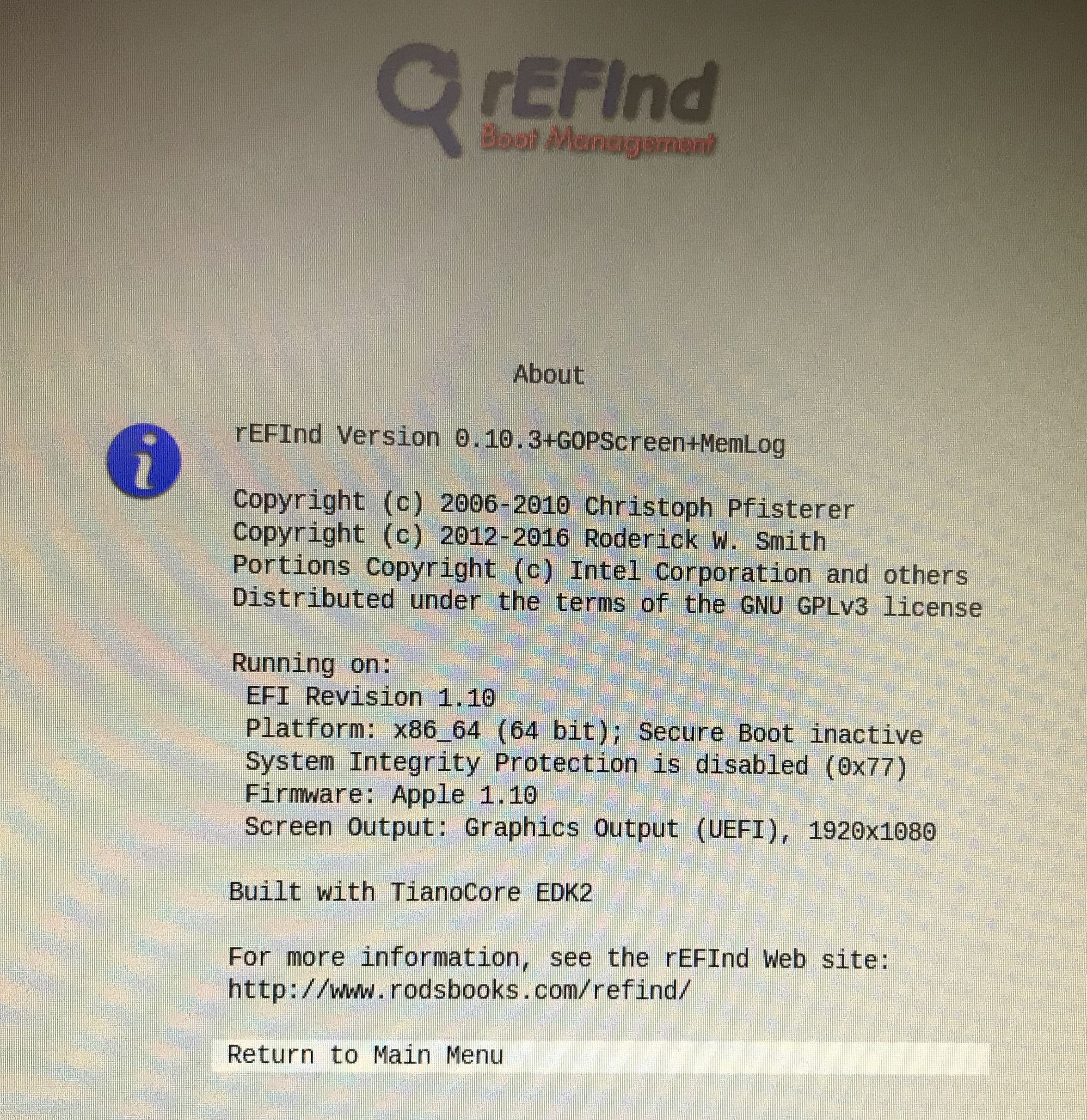

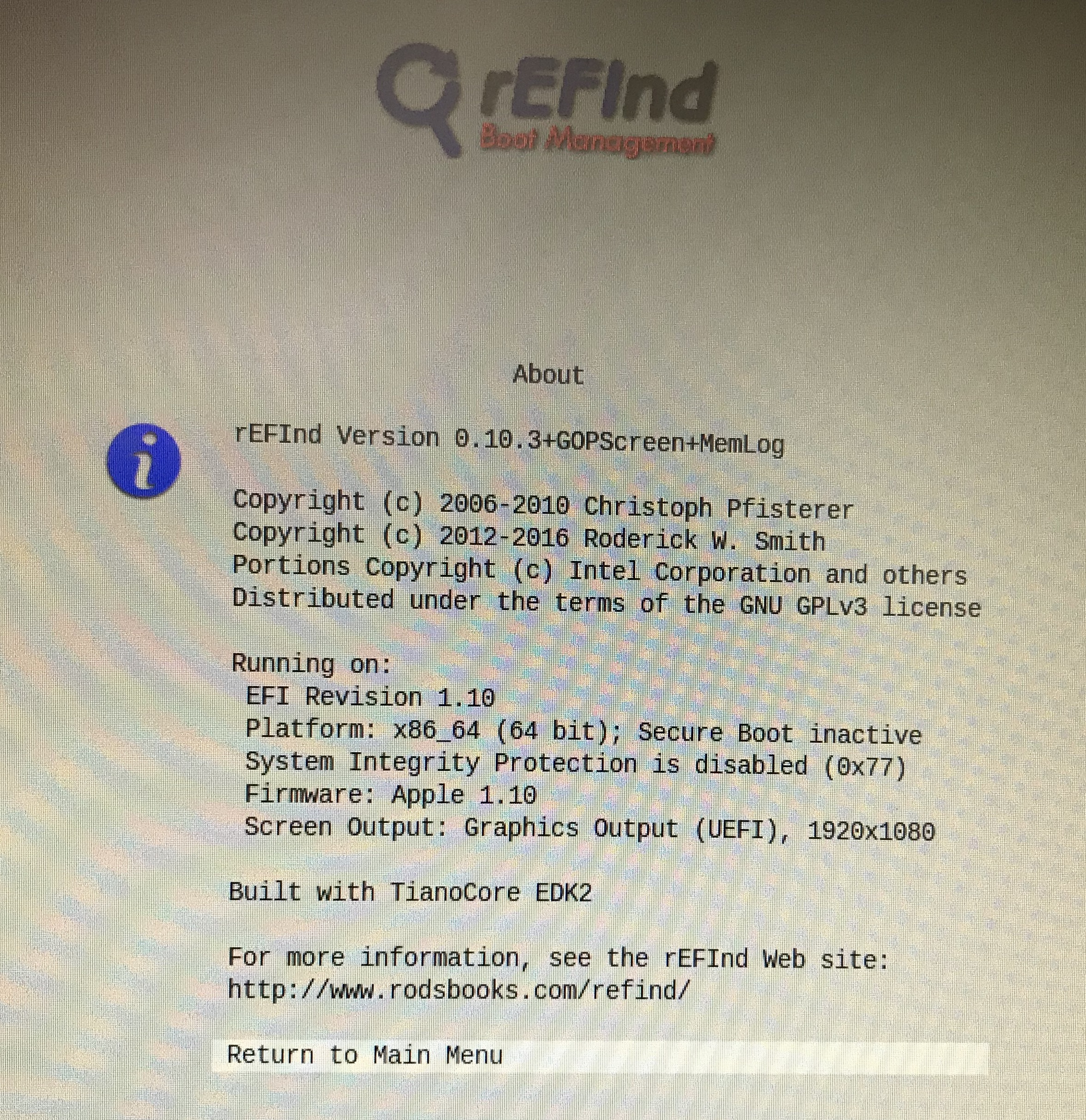

You should now be able to reboot and see the rEFInd boot picker, it looks a little bit like apple's setup but has some other features.
This is what you should see in the about page in rEFInd to confirm you have the right version installed.
version 0.10.3+GOPScreen+MemLog

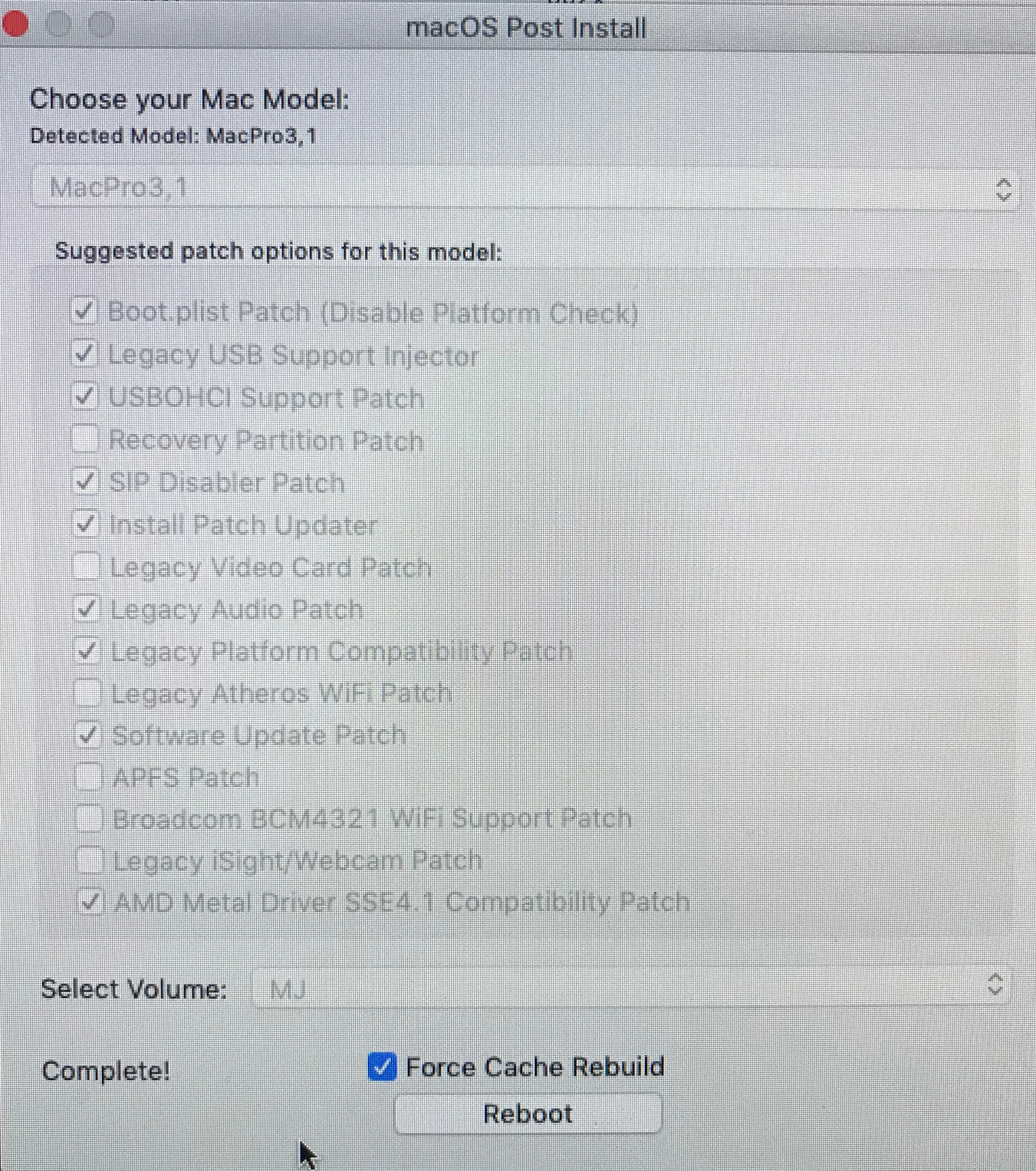

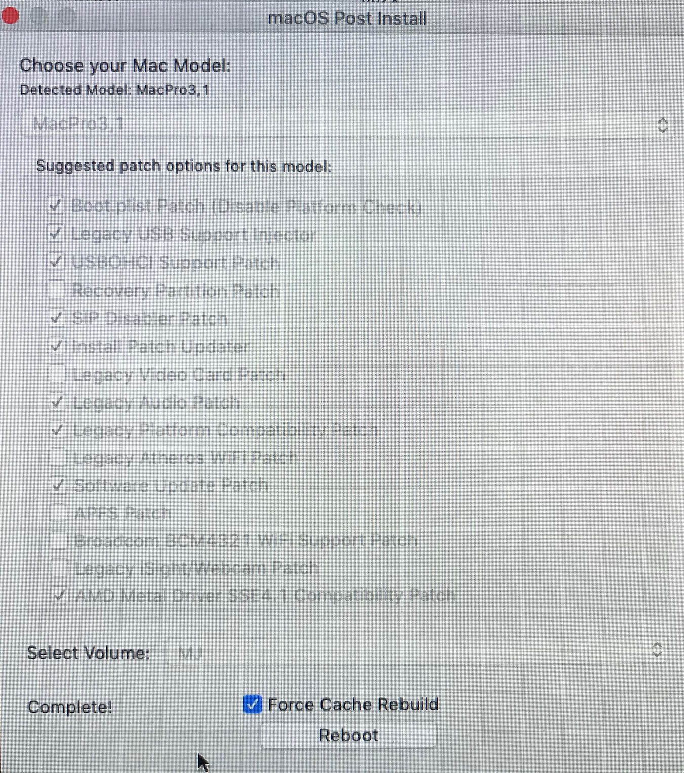

Start the Post Install tool from DosDude1
Choose the patches you need, then tell it to reboot.
DO NOT, DO NOT, DO NOT USE THE LEGACY VIDEO PATCH.

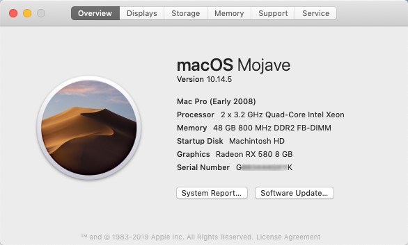

You are done, now don't install any macOS updates, or you will break your video driver.
Feel free to enable / use FileVault, as it will "just work" for the 3,1 and now with your setup you don't need to hang on to an ancient GPU for "boot screens".

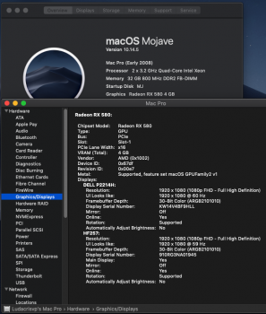

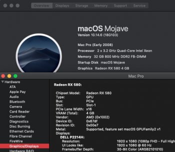

Now if you want more fun, look at enabling AMD Hardware Acceleration for h264 / HEVC video encode / decode which will let you play 4k content on the 3,1 flawlessly with very low CPU usage. I'm using this and it has been a very nice addition to the 3,1.
Once the SSE4.2 limited instruction set emulation kext by @Syncretic is released from beta, this will allow you to run with the RX 580 on any version of macOS that the GPU is supported in (Catalina as well) and there will be less messing around as it should be able to be properly integrated into the dosdude1 patcher eliminating the need for the single user mode actions.

Step 1: Install Mojave
  • Create DosDude1 Mojave USB and install Mojave following the Standard DosDoude1 Process.
    • Don't apply any of the adjustments in Section 2 of Post 1 for now. Just get Mojave installed.
    • Remember to heed the warning by @Ludacrisvp not to do the legacy video card patch.
    • Use v1.3.7 or later of DosDude1 patcher

  • Reboot and you should get the rEFInd Boot Manager.
    • Check the "About" section and made sure it says SIP is disabled
      • If it says it is not, and using the version I linked above, toggle SIP off using the small maroon shield icon on the second row
    • Select your Mojave drive and proceed

Step 3: Activate RX 580
  • Shut down, insert the RX 580 and you should be done and set up when you reboot!
    • Keep a copy of your original card for last ditch recovery

This is my diskutil list:
I use ESP Mounter Pro to easily get into my EFI partition.
I run your command to bless the file:
sudo bless --mount /Volumes/EFI --setBoot --file /Volumes/EFI/EFI/refind/REFIND.efi --shortform
I did not use the chown command as I used Kextbeast from Dayo's instructions. The card does work once I'm in Catalina. I'm going to try going through the steps again with the RX 580 already installed.

you mentioned your chown command didn’t work, did you do zero:zero (0:0) or the letter “O” (O:O)? As the UID/GID for root:wheel is 0:0
I can't believe I would have used letter “O” (O:O) instead of zero:zero (0:0) but not outside the realms of possibility. Kextbeast worked well and better anyway.
Side Note: Actually no need for any kext installation with latest versions of the DosDude patcher.
[automerge]1575519848[/automerge]
Yes, refind worked when I had the ATI Radeon HD 2600 XT 256 MB card. I've reset the NVRAM, ran the blessing again but no refind menu. The monitor's screen is black and the LED shows amber like no signal is being received, then the LED goes white and the login screen for Catalina shows up and I can login.
Aha! Now I get that the issue is not that the whole thing fails but that the rEFInd Boot Screen is skipped and you go straight to the OS Splash Screen.
I had that when I tried to follow @Ludacrisvp instructions. Wasn't sure whether it was because I had messed something up along the line and while it was a nice and fast boot experience, I wanted to have the rEFInd Boot Screen so I could swap drives etc.
Probably best to fully follow one or the other of the instructions. You will notice that the bless command I gave is slightly different to the original. The shortform tag was causing problems for me for instance. Also not using the mount tag as installing to a boot volume (This can be a USB Drive).

Lack of shortform tag can cause long delays during boot from what I recall.
i would try other ports on the card I suppose.
You have a refind.log file generated inside the EFI partition ... can you post it?
