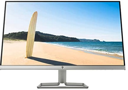

I have bought a HP monitor 27FW with Speakers. It's connected with a HDMI cable to a Geforce 980 in my Mac Pro 5,1. But I have no sound in the speakers. Do I need an additional cable?
Monitor 27 inch HP

The rear components are described with a pic on page 3 of the manual. If you're only wanting to use the speakers on the monitor itself, I'm not sure how to help you. I assume you've checked whatever control panel is available with the monitor as well as the macOS sound preference, volume control, etc.?
Monitor 27 inch HP

I'm thinking that the old Mac Pro doesn't send audio through the HDMI port of those cards, particularly if it's a 3rd party card with flashed firmware.
Have you been able to verify that audio is sent via HDMI with a different monitor or TV?
