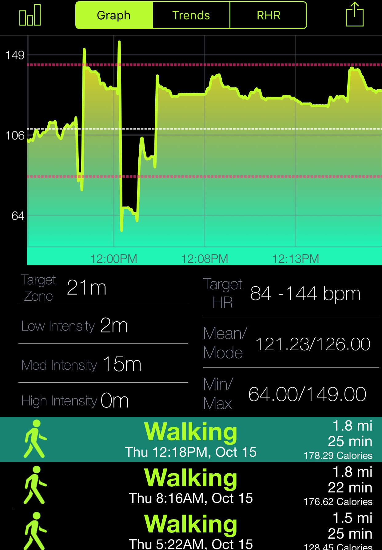

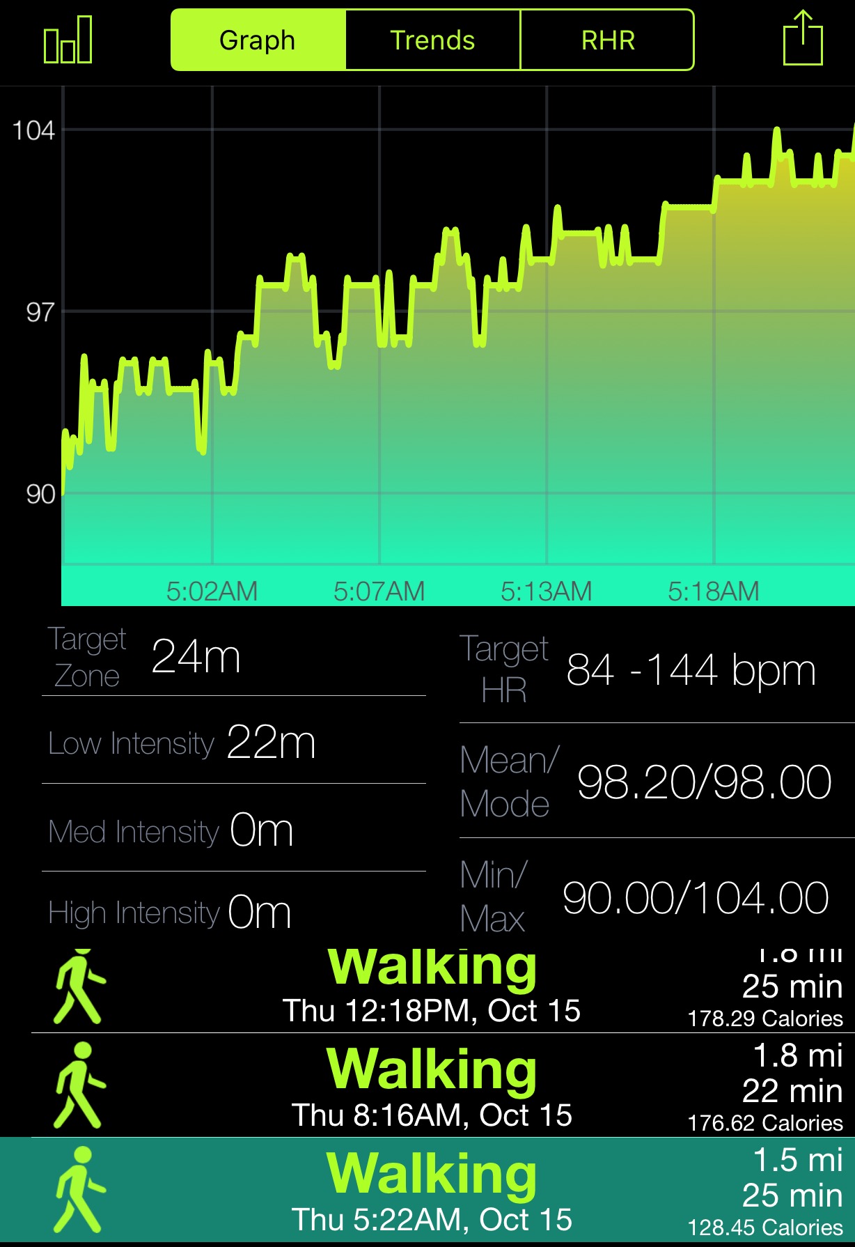

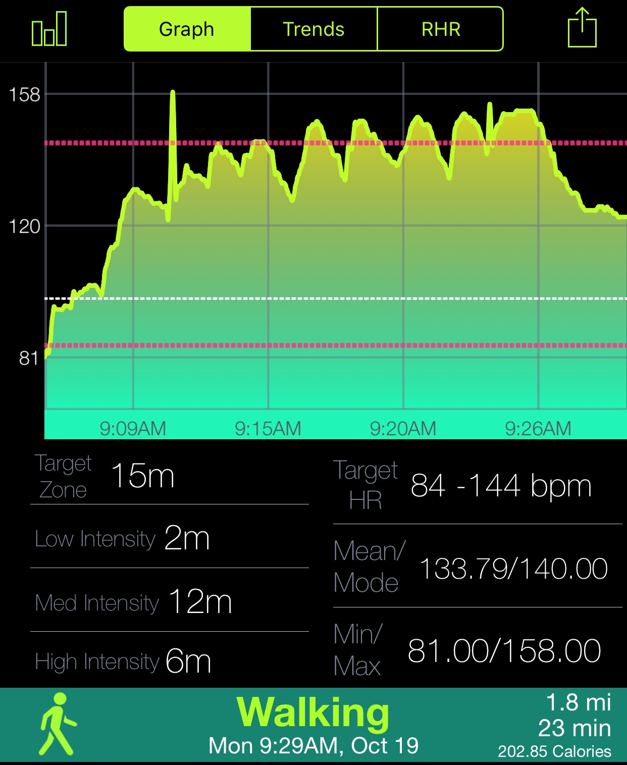

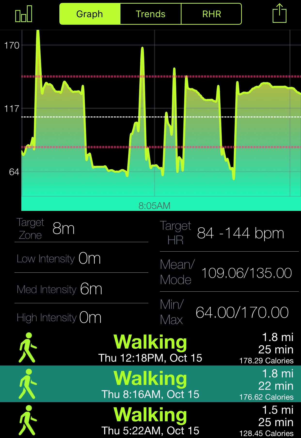

I may be in the same boat as you. I did a walk/run earlier this week when it was 32 outside and the Apple Watch did not have much luck and I am someone who has always had success. My Readings were all over the place. I was doing A simple walk with some sprints... nothing serious as it was too cold and all I was wearing were shorts a t-shirt and a long sleeve hoodie. Here are two attempts and what happened to me plus a treadmill walk earlier in the morning. I thought it may just be a fluke but now I don't think so and since I didn't workout long either time, it may be a temperature thing...
Since I had the watch on all morning and under the hoodie, I wonder if it has anything to do with my body feeling the cold more than the watch?
