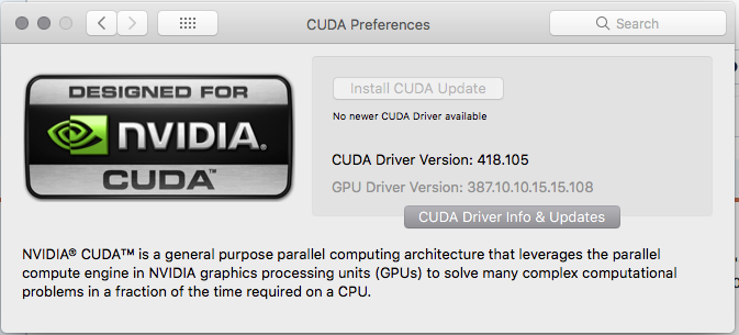

I'm running these web drivers as well but there was a patched Cuda driver released that doesn't play well with that web driver apparently. Are you sticking with the previous Cuda driver since you're on 387.10.10.15.15.108?
Guys beware. I cannot confirm this! In my case, Webdrivers do not work any more, the system uses macOS provided drivers (no acceleration, no CUDA).
Card: GeForce GTX 1050 Ti (Pascal)
There is a CUDA conflict with pulled driver and newest CUDA 10.1 driver. Most will never see or experience, but if you run into strange CUDA errors or rendering glitches, this is first troubleshoot.
Reactions: Alex Sanders74
Good to know. I use Octane render with Cinema 4D, so I'll keep me eye open for issues... So far it's been fine.
