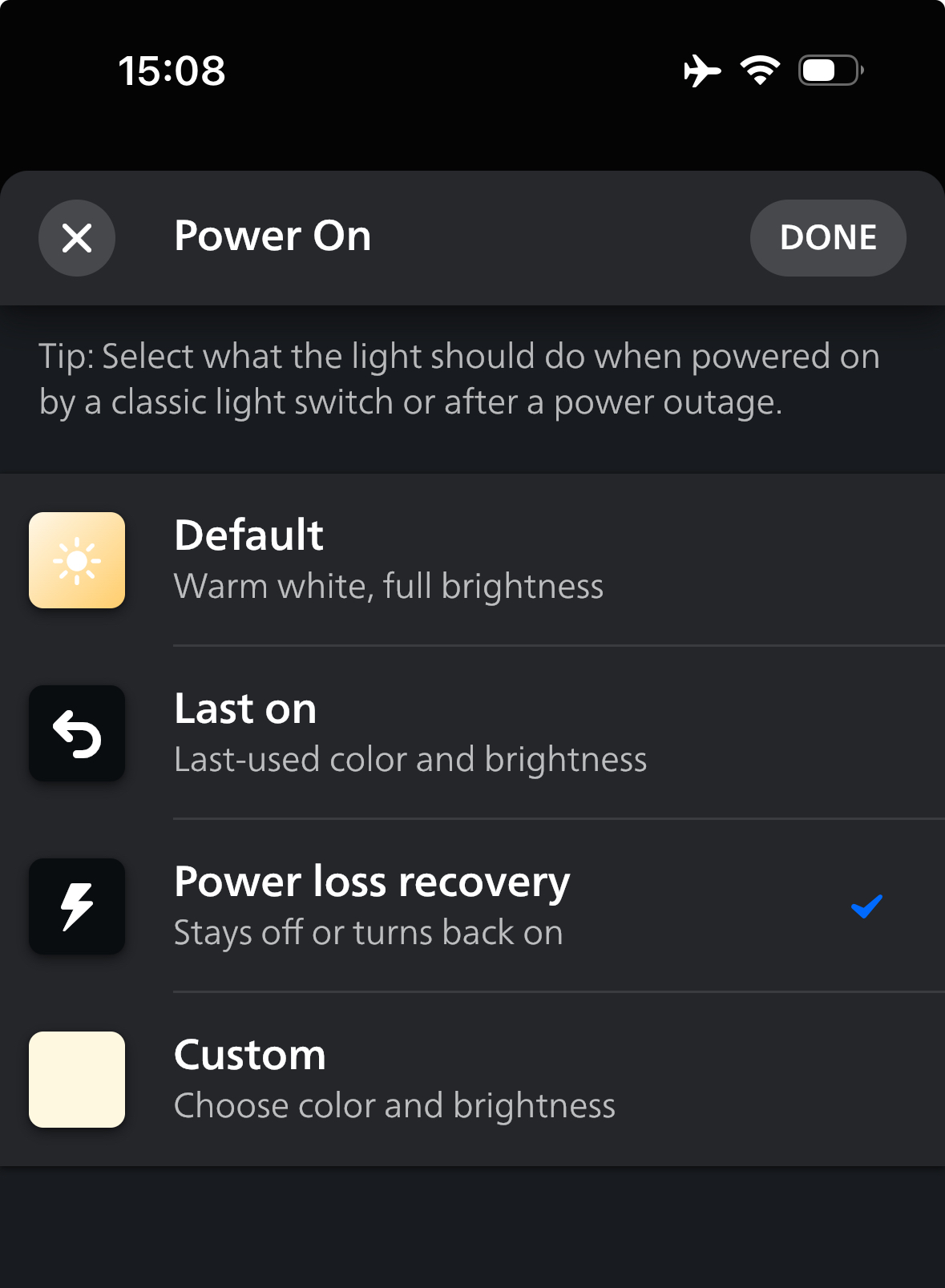

That's normal. But it can be changed. In the Hue app, go to Settings > Lights. You will see a list of every Hue bulb in your home. You then have to select each light and choose its "Power On" behavior. The only I think you want is "Power loss recovery" which means the light will stay off if it was last off, or will turn on to its previous setting when turned on.

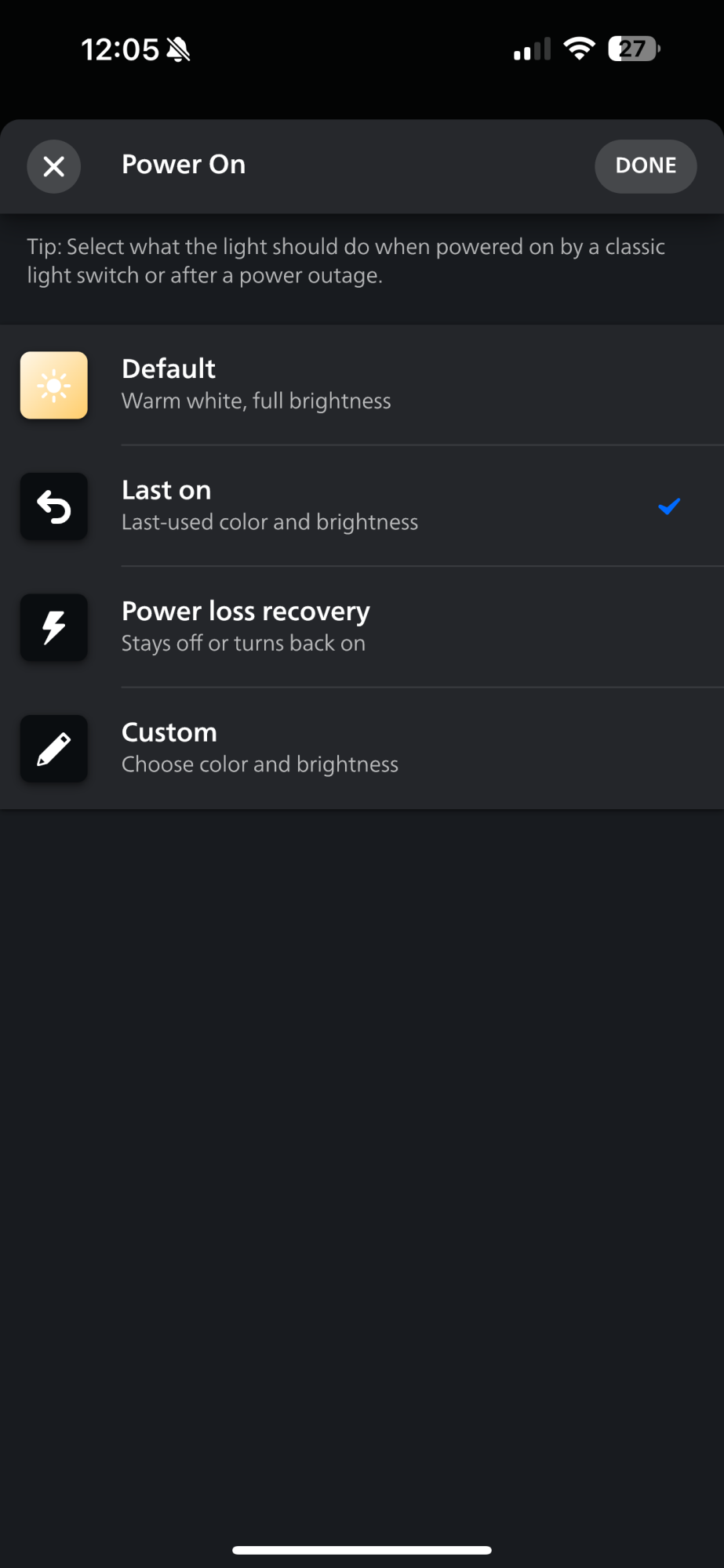

Thank you for pointing me in the the right direction, Power Loss did not work out, but "Last on" works like a charm. Although I think there was some lag (2-5min) at the beginning where I would turn off/on via switch and it would go back to 100%. I waited like 5 min after setting things up, and my lights are working, no issues anymore....

Power loss recovery is when you actually have a power cut, and then power is restored...or if someone switches the light off at the wall switch.......the lights will comes back on with whatever you configure it to in that option.
