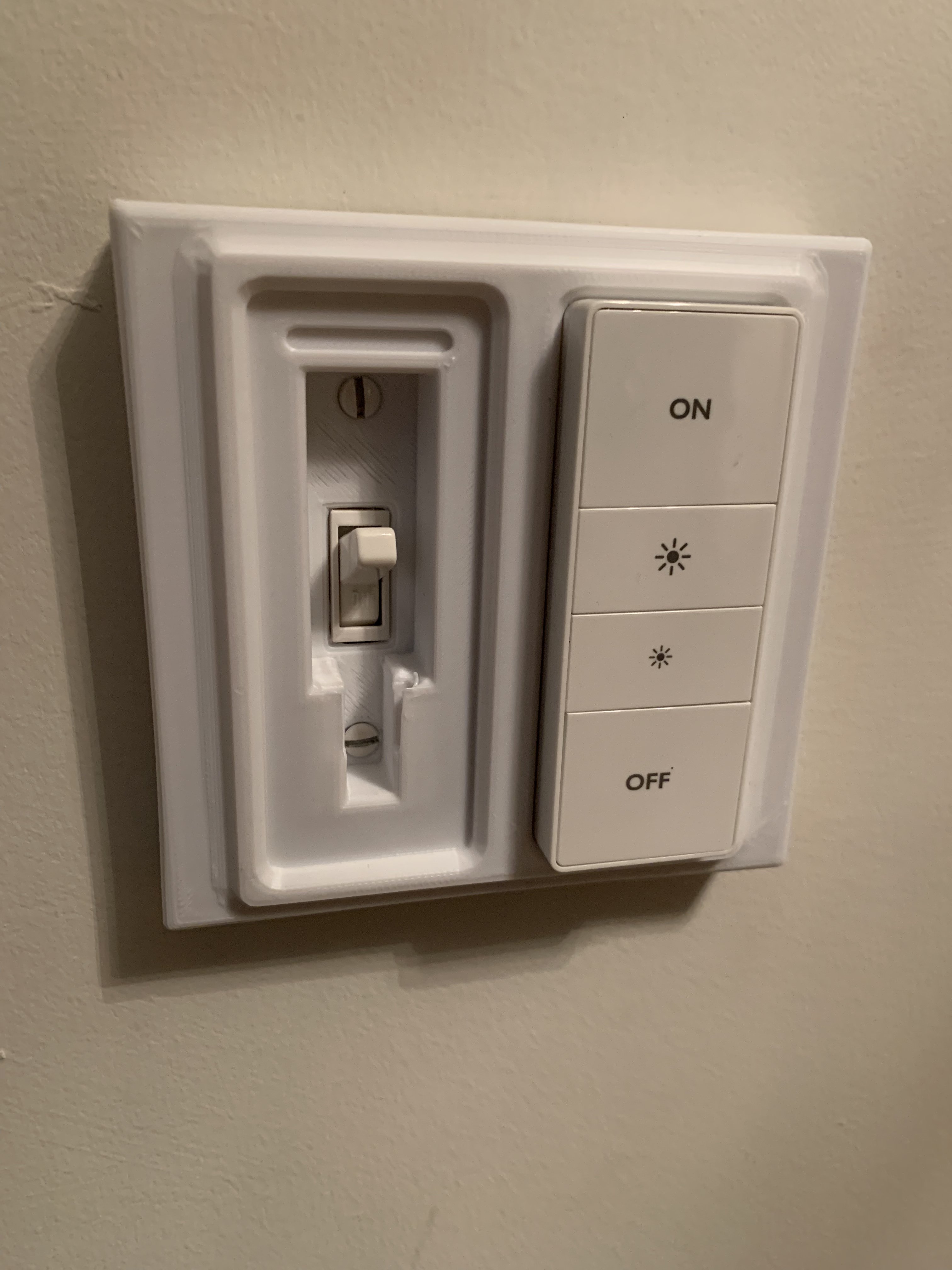

This is what I have now pretty much. Found these on Etsy in a bunch of different forms. I just leave the switch turned on behind it. Not terrible but not great when you have a 2 gang and one of them doesn’t accept Hue bulbs and they do stick out a bit. I’d probably be happy if the Hue Dimmer just had an LED night light locator. Now to figure out how to get that setup LED to stay on lol
