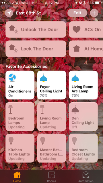

This is what I'm getting.
Home app. "Updating" for extended time--before showing each light's state, brightness, color. Lutron lights and other accessories update instantaneously when opening the Home app or Control Center tab.
My devices: all accessories update instantly.
Fiancé's devices: all accessories update instantly EXCEPT Philips Hue ("Updating" for several seconds)
