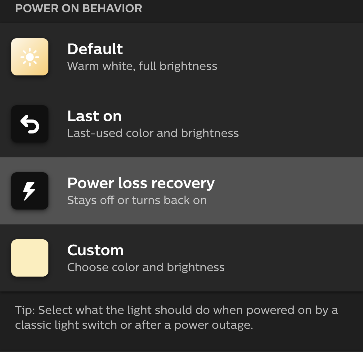

Just a thought but could it be random power outages? Do you have “Power Loss Recover” turned on?
I have had that changed since they added it. we woke up a few times to power blinks. but no power blinks that I could tell and al the lights are set to stay off when the power blinks.
