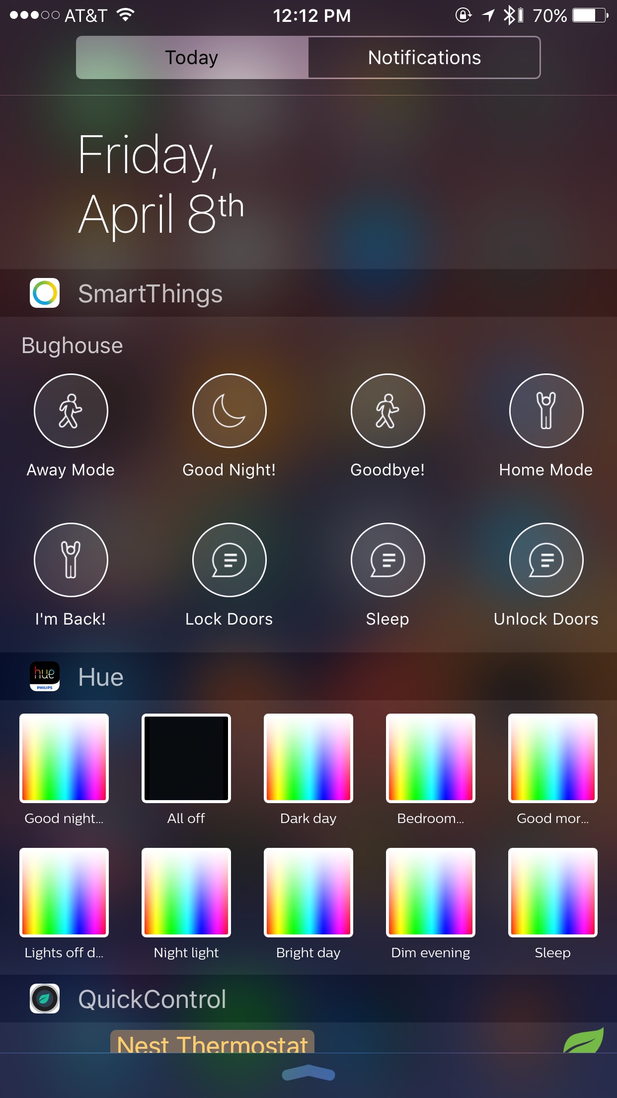

I have pretty much given up on it. it is faster to use the today widget. I have gotten it so my wife can turn all lights on or off with siri and it is all she needs as she is blind. the rest us automated for the most part.
Huemote looks similar. I'm using it now to get me through the rough patches as well as making new automations instead of groups. So instead of a group called "Both Living Room Lamps" I made an automation called "Turn On Both Living Room Lamps" Harder route to the same goal. I agree the buttons are quicker but two problems: I found that the hue bridge doesn't like to receive from more than one device, except shared HomeKit commands, and also for the price I paid I want voice commands like Star Trek!

My wife and two of my children use their phones and iPads to control the lights, it's never caused any issues. We tend to use Huemote for simplicity, it's just so easy to click swipe and choose the setting you want. We all have different settings in our widgets depending on what we use - I don't need to adjust he kids lights for example and they done need our bedroom.
iConnectHue is great for extra features, but for speed it's not so easy to access unless through the widget. I like being able to programme my Tap switches so easily through the app, each button has multiple presses set up, each Tap is set up differently depending on where it is.
Most apps just have too many features that we don't need for everyday life. We don't need fancy animations, although I use one to call my kids down rather than shouting and it's programmed into a Tap in the kitchen. Other than that I just have several settings - Daytime, Evening, Bedtime, Goodnight etc - and a couple of animations for slow fades in the morning.
