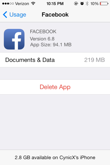

You'd be surprised with the amount of data an app can cache.
That's 219 mb for just one app.
358 mb for another.
So in 2 apps so far I'm at 577 mb. Plus 1.7gb in text messages. Etc etc it adds up quick.
Edit : look at the times at the top then the usage at the bottom of the pics. I gained 100 mb just by looking at them? Maybe the OP is on to something lol
