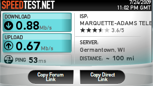

I can't show you my speed test case I am trying to sell my Mother in Law on Alltel over her current Century media dial-up, but I usually have a test about
100 latency
over 1mbs download
and .65 mbs upload
which is faster than my DSL which specs out as:
Oh yeah I bought my the UtStarcom outright cuase I didnt want to be locked into the 2 year plan. search ebay for the modem and make sure it is Altell.like this one
http://cgi.ebay.com/Alltel-UTStarco...trkparms=65:12|66:2|39:1|72:1205|293:1|294:50
Hopeflly I didn't break any rules here.

<50 miles:
~350 miles:
~1200 miles (too lazy to find something at ~900 miles like yours):
Hope that helps!
Does it matter which server you are hooked up to at speedtest? seems like all your reslts are the same. Also 9 mbs I didn't realize you could get download speeds that fast.
I actually don't know, my dad bought the service and he doesn't know what he got, he just wanted something fast enough for home. But at like 0.xx MB doesn't it take forever to load a page like MR? It takes me long enough to load this (like 8 seconds).

You have 12ms latency. It's physically impossible to get a signal to a geostationary satellite in under 500ms. Usually, it's 700-800ms.
There are low earth orbit satellites comms where you can get around 50ms, but I can guarantee you that you do do not have one of these systems.

Judging by the ISP shown on your speed test results, I would wager that he has cable internet from Rogers 😉
