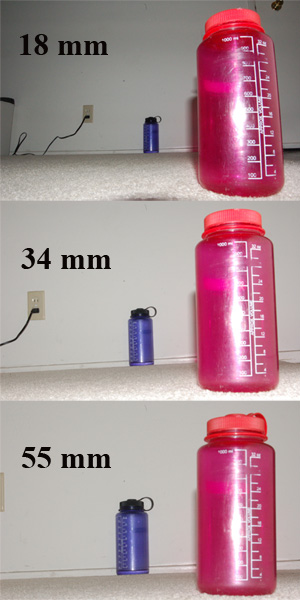

I'm going to hasten a rather uneducated guess: does it have to do with perspective distortion rather than with field of view?
For example:
Or not?
I think you may be correct. While being trained in photographing archaeological gigs, I was told that a 50mm lens was preferred because it captured perspective and proportion most correctly compared with wide angle lenses.
The more I think about it, it probably does have to do with field of view. The effect in the image I posted above relates more to distance from the object than anything else.
[Edit: I just read your post, Lord Blackadder. We must have been typing at the same time. So maybe it is a perspective thing, but distance is still an issue. I just lined up a couple of bottles and looked at them up close and from far away. I could see similar changes going on with my naked eye (that is, similar to what the photo shows).
