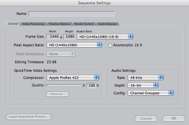

I hope you get around to responding to this despite being several months late, heh. But can you tell me the settings for your sequence when you edit? Is it like this default setup?
HD (1440x1080) (16:9)
Pixel Aspect Ration: HD(1440x1080)
Editing Timebase 29.97
Compressor; HDV 1080i60

I've attached a picture of my sequence settings. I'm using ProRes422, but i'd think whatever codec you use out of JES would go here.
I think that iMovie 08 captures your footage with AIC, but I am not sure. I had a few Log and Capture issues, but I was capturing to an external drive. Once I switched it to internal, all was fine.
If your footage out of JES was still 30p (29.97), could it be that you just selected "deinterlace" from JES's Project window and not "Inverse Telecine"? I know that doesn't seem like a likely mistake, but it might be worth revisiting. You can always open that footage in Quicktime and open Window > Movie Inspector. It looks like you Editing Timebase and Compressor are probably off. Editing Timebase for your sequence should be 23.98 and compressor will be what ever codec you used out of JES. Everything else looks fine.
