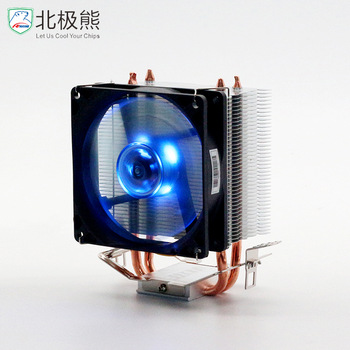

I'll let you know if I find a solution, but at this point my guess is that it would require an customheat-pipe with a lower vapor point. Since my screen recently went bad, I might just turn this into a franken-mac and put a big aftermarket heat-pipe on it :) I'd imagine this one might help haha..
