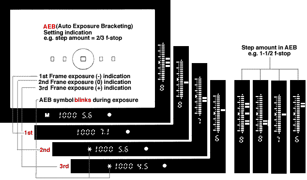

Okay, hopefully you have the basic idea now: bracketing is "insurance" to make sure that you got a good exposure for the shot that you want. What this also means is that if a photo is really important to you, you may choose to make more than just one shot above and one shot below. What you'll find on many SLR's is an automatic bracketing feature. On consumer cameras, this feature generally offers half stop (0.5) adjustments, whereas on professional grade SLR's, it might be in on third stop (0.33) adjustments.

This shows what an SLR camera's displays might look like while you're trying to do this. Don't worry...each camera is different (this one looks a lot more complicated than mine!). One thing to notice are the bar graph indicators on the right side, and how the little arrow on the left side that indicates "proper" exposure isn't always matched up with the white rectangles on the right side. This is showing you what the setting variation is for that specific shot. FYI, on many systems, when you set this up (AEB: Automatic Exposure Bracketing), it has a three image sequence setting: first shot normal, #2 high, #3 low.
With a little practice with AEB (for where you need it), you get used to the idea of composing, then "click-click-click", then moving to the next composition, 3 shots, next composition, 3 shots, etc. Obviously, in the days of film, this meant that a roll of 36 gave you only 12 sets of 3!
