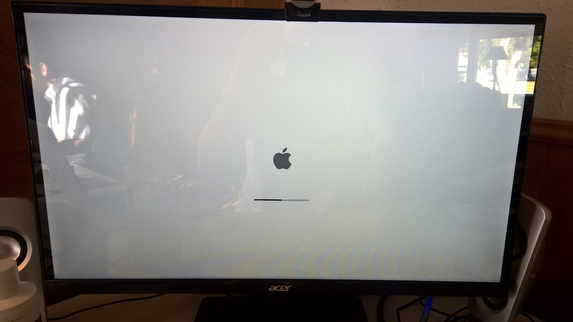

So everyone, I am about 2 minutes away from taking my mid-2010 MacMini out into the back yard with my Glock for it to meet it Steve Jobs. Perhaps someone can save it before I take it out back and shoot it.
I have purchased a Patriot Blast 240 Gb SSD (states on the front of the box "Mac Compatible".)
I used SuperDuper! to clone my HD onto the SSD, and while it was plugged in via USB after the clone it booted onto the USB based SSD no problems. I was able to unmount the old HD and I used Drive Sensei to enable trim on the new SSD while booted off the SSD.
This SSD is not on the unsupported list, so in theory it should work. My symptoms are different than most trim related issues. Instead of seeing the crossed circle upon start up, the thing boots like normal -- gets to the half way point (I assume where OSX (10.10.5) attempts to load the HDD kext) and stops. Nothing -- nada -- zilch -- nothing more comes.

I thought -- okay I'll just disable trim and do it manually once and a while. I wiped the SSD and re-imaged it and repeated the steps with trim disabled. Same. Exact. *****. Problem.
I refuse to pay Apple to do what should -- be a simple plug & play operation.
I have attached a photo for you all to laugh at my misery.

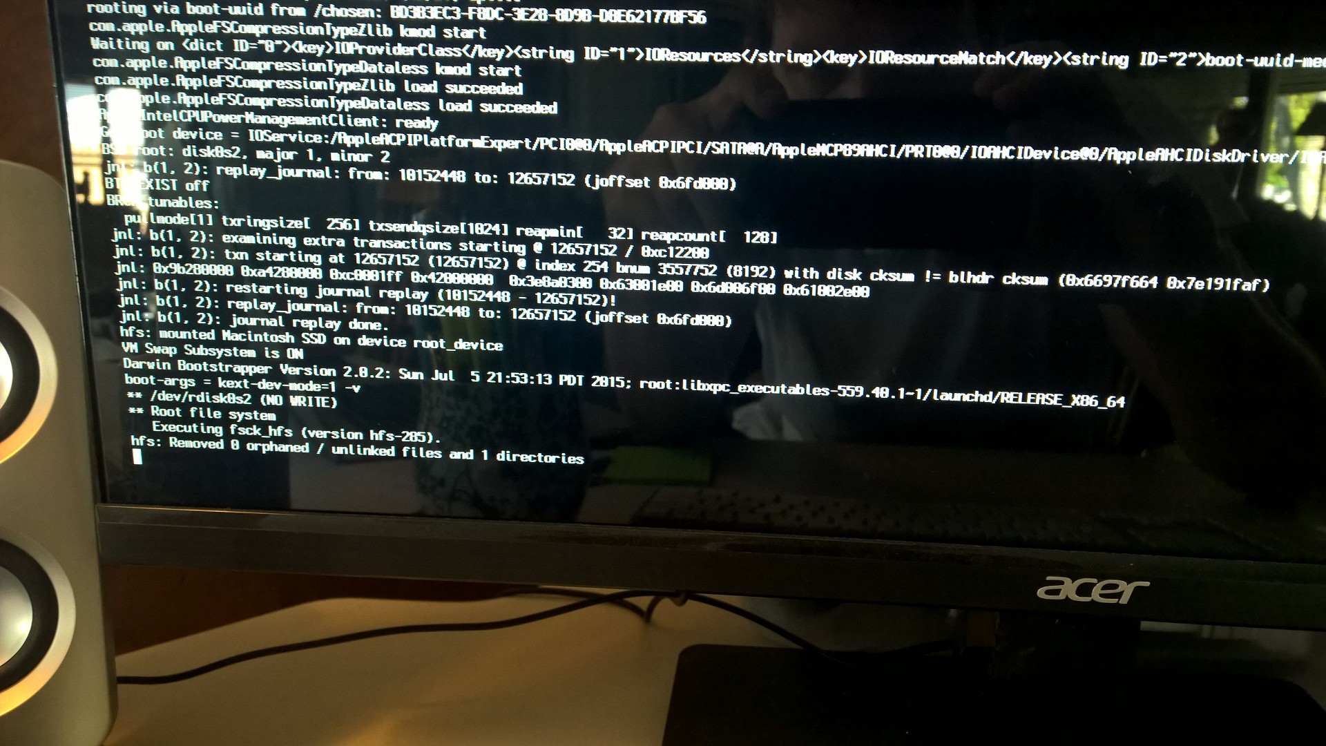

EDIT I hit CMD + V and the photo thereof is also attached.

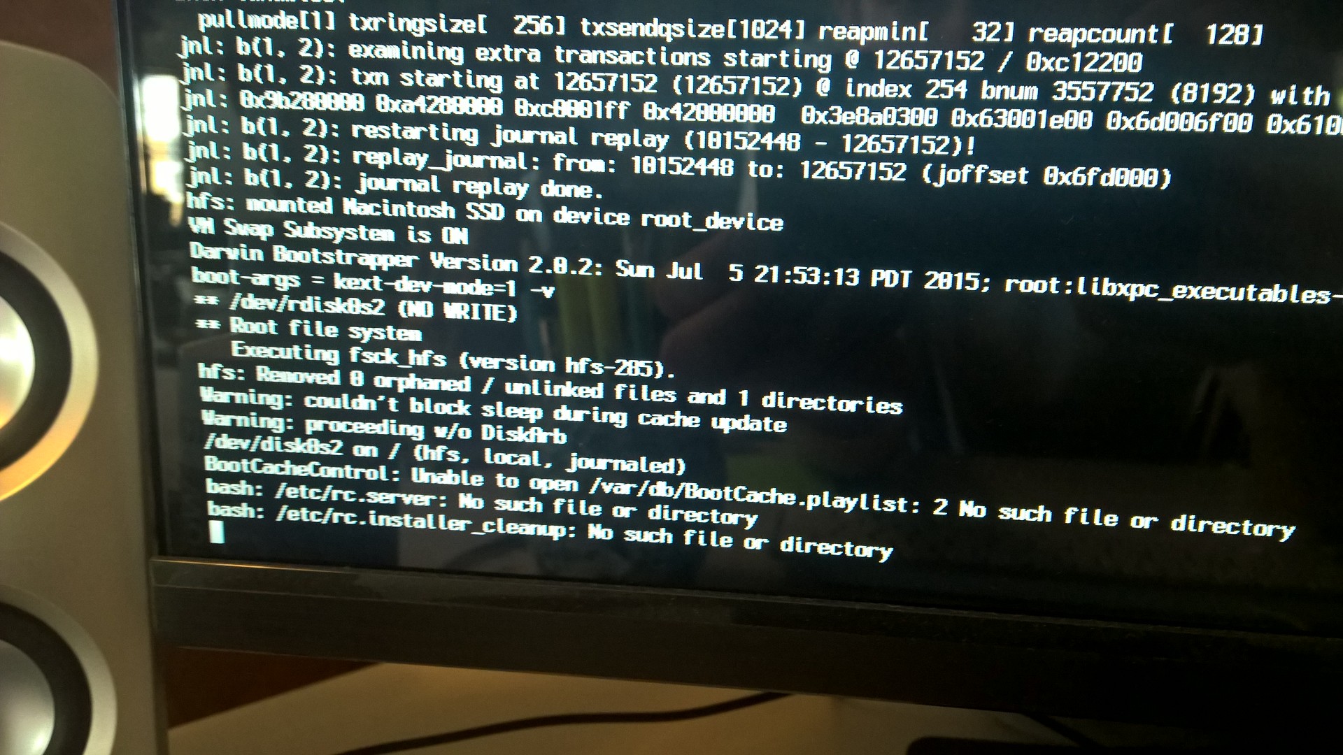

EDIT 2 bash updated it a little bit more. An additional photo is attached.

Command + V keys at the same time when you start it up to get a verbose (text) boot so you can at least see where it fails, then perhaps people will have a chance to help.
Thanks for the screen shot, your SSD is a dud, it happens.It's not your MINI. I wouldn't use anything "PATRIOT",I have always used OWC, ALWAYS, never a dud or a problem, IMO,"bullet proof"🙄, if you'll pardon the pun😀

I think I'd try just a clean install of a brand new copy of OS X on there first. Then, if that works, use migration assistant to transfer your files from the old disk.
Also, reset NVRAM to undo the changes you've made with TRIM. TRIM is easily enabled without using a 3rd party tool now, and then your system can't break if you upgrade it.
I think this is where you went wrong and now it won't boot because it. Reset NVRAM to default and boot back to the old drive. Then erase the SSD and clone the HDD back to the SSD again. Then install the SSD and boot to it. Now run the command below in Terminal enable TRIM then reboot.
Code:
sudo trimforce enable
