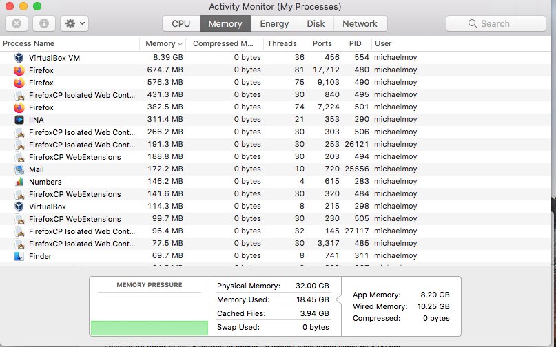

I had a 8GB M1 MBP overloaded for a 2 week test drive. I was running all of the following at the same time:
  • PHPStorm
  • MAMP w/2-3GB RAM server
  • Parallels w/Windows ARM
  • OSX Mail
  • Photoshop
  • Terminal
  • Firefox
  • Safari
  • Quickbooks
  • Capture One Pro
  • Other random small programs
My 32GB 2018 MBP was getting its battery replaced and I decided I'd get an under spec'd M1 as a trial. I was going to run it hard and see how it did. If it survived, I'd just keep it and sell my 2018.
I was really really impressed that it continued to perform even with all I was throwing at it. I'm sure I could have found ways to destroy it, but under realistic scenarios, there were no significant performance hitches. The reason why I ended up returning it was because I racked up 5TB of writes in 9 days without putting in my normal long hours on it.
Even if I had ended up needing 10TB of writes a week under my normal conditions, the SSD should have been able to hold up for as long as I would have owned it, but I took it as a sign that even if an 8GB unit would work, it wouldn't be the best decision for me.
I'm pretty sure the massive writes had something to do with my Web development work. When I wasn't working, the writes were elevated, but pretty reasonable.
My test drive may not have ended up as I wanted, but if I ever had to get by on an 8GB machine, I now know I can do it pretty comfortably.

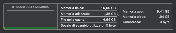

Memory pressure via activity monitor on MacOS Catalina 10.15.7 and dedicated GPU (no integrated GPU shared memory).
Daily activities like some Chrome tabs opened, some instant messaging apps, Discord, Spotify, VPN app and TextEdit.
Memory pressure is 70% without coding, office apps or video editing.
Sincerely I have no idea how users can be satisfied nowadays with their tasks with only 8 GB of memory.

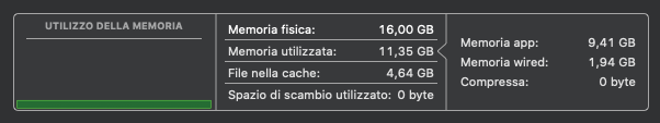

Your machine is showing zero swap, zero compression, and your memory pressure is green so... I'm not sure what point you're making here?

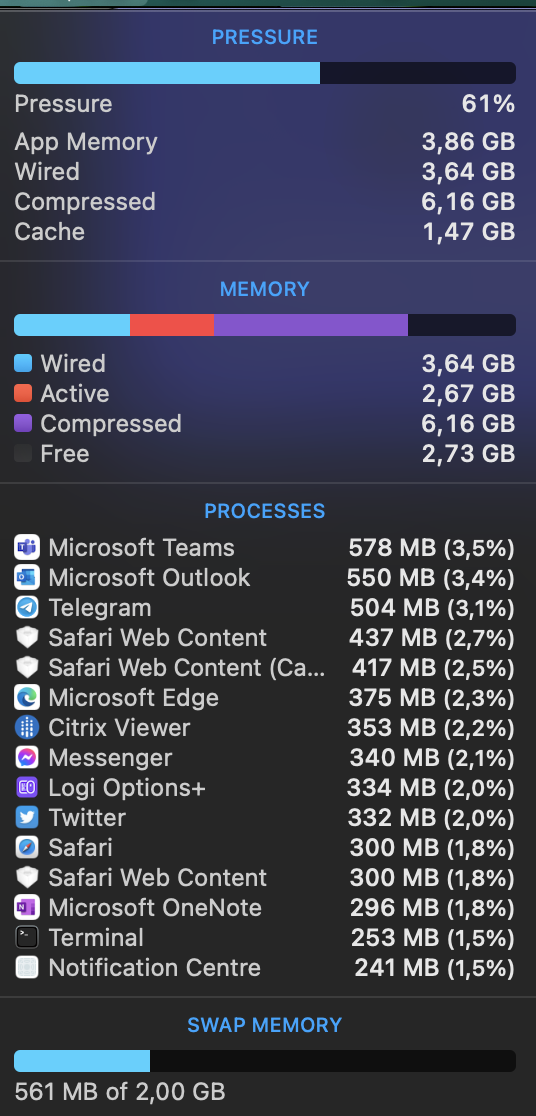

Same here...
Can't use VMs when I have like 2,73GB completely free and 6GB being compressed...
I have already great memory usage just with daily tasks without using coding, office apps and video editing. And I have 16 GB of memory with dedicated GPU.
With these premises, M1 Macs with 8 GB of memory soldered onboard are literally useless and even M1 Macs with 16 GB of memory will become obsoleted in a couple of years because they aren't upgradable after the purchase.
It doesn't even matter how hard you try, RAM is a real bottleneck. That's the point.

You don't have high memory usage, though. Not according to the screen you posted.
OSX dynamically allocates memory. Programs will request and be allocated a certain amount of memory, which may well be in excess of what they actually need or are using at any moment. As additional allocation requests are made, memory will be reallocated between applications. Often, these reallocations can be made *without* paging data out to the disk, because the app doesn't actually need as much memory as it has requested, at least not at that moment. Unless and until these reallocation result in data in memory being compressed or swapped out to disk, there is no impact on performance. All other things being equal, you *want* the OS to use as much of your memory as possible, because otherwise it's just sitting there doing nothing.
It may legitimately be the case that 16GB is insufficient for your use, but your screen capture does not support that conclusion.
You don't, though. Not according to the screen you posted.
Your screen grab is a direct contradiction of your own post.

Dynamic allocation or not, it's an insane and unjustified amount of memory usage for the simple tasks I have reported above.
Contradiction? 11 GB of memory for basic tasks like Chrome tabs, WhatsApp, Telegram, Discord, Spotify, VPN app and TextEdit is your concept of contradiction?
It's clear you don't understand how memory management in macOS works.
As others have said, the OS tries to use as much memory as possible. This includes caching previously used applications for example to try to fill up that RAM. If there is less memory available, macOS will adjust as needed.
Your usage description in that screen grab would have been handled perfectly fine with 8 GB RAM, with normal green memory pressure. There are many situations which need more than 8 GB, but your screen grab does not at all demonstrate that. In fact, it argues against what you are trying to claim... as several other posters here have already indicated.
