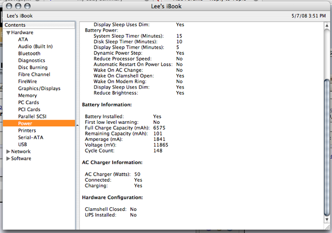

You can also go to the Apple in the top left hand corner and click About This Mac. Then click on more info, Hardware and then the Power tab. You can see the information about your battery there if you haven't downloaded Coconut Battery yet.
Also check to make sure it's not your AC adapter that's at fault.
