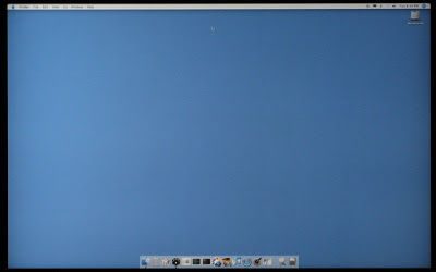

you've still not been able to post me a photo of a good imac - you'll tell me next that cameras aren't able to take pictures of good screens
Why has it become my responsibility to search the forums and point you to the threads full of photos from gradient-free iMac owners?? You seem to speak English well enough that you could accomplish this on your own but I'm in a giving mood this evening:
https://forums.macrumors.com/threads/371616/
Knock yourself out.
Taken under the camera settings specified by Leon to not over saturate:
Extreme left and right edges cropped and put next to each other:
