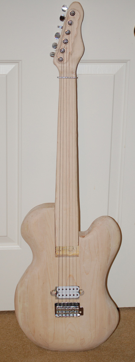

As the title says I built a guitar. Two days of work at 8 hours a day (just got out of school lots of free time), so 16 so far, and will finish up wiring and decide on how to fret the beast tomorrows.
I title it "the beast", it weighs at least 25 pounds the neck it real wide and real thick. But its a good thing cause i got big hands.

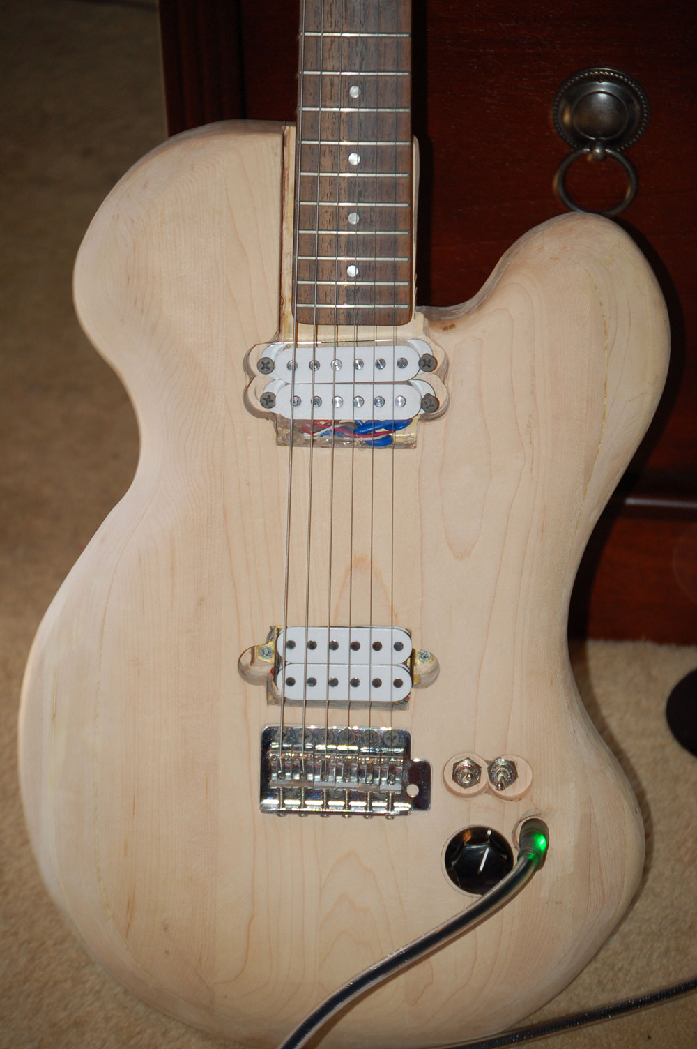

I stole the pick ups out of Yamaha eg-112c the bottom one stayed a humbucking and the top two are being molded together to become another humbucking. The bridge was stolen from it too but was highly modified.
I don't think i'll paint it, any time soon at least, but might give it a dark stain maybe.
I'll record how it sounds when i finish the electrics in side and gets frets on. (dang it is hard to play without frets)

yah the neck is a bit crooked, that was one hellish cut, It started out as a 4 foot long 5 inch thick and 5 inch wide block of maple. The body it self is maple, 4 1/2" sheets glued together.

I might work on the neck, but i really don't want to shave too much more off cause well i don't have a truss rod in there...
I might give up the neck and get a pre-built one, just have to see have fretting it without fret wire goes. The only reason I'm fretting it is because I cant get any sound out of the high E string.
sure? It's a 1-3/4" thick, 2-1/2" wide piece of hard maple. Have any ideas on how to one in there?
Yes, I'm sure. It's like having a 75kg weight one one end of the neck.
You put one in you need to cut off the equivalent of the fretboard, route out a channel and install the truss rod. Then glue the fretboard back on.
Joe Driskill puts carbon fiber in his necks under the fretboard for added rigidity. So, actually, that's not a bad idea.
Yeah, dude, you're definitely going to need a trussrod. Have you read any books on guitar building? What was your process of joining the neck to the body? How's the action going to be?

I'm very impressed with the results, looks like you spent a good amount of time and effort. Sounds pretty good too.
Great job, glad to see hard work paying off for someone.😎
^^ glad you liked the sound. I was worried for a while. My pickups were placed to low and was getting a muddy and all around... well F***ed up sound.
