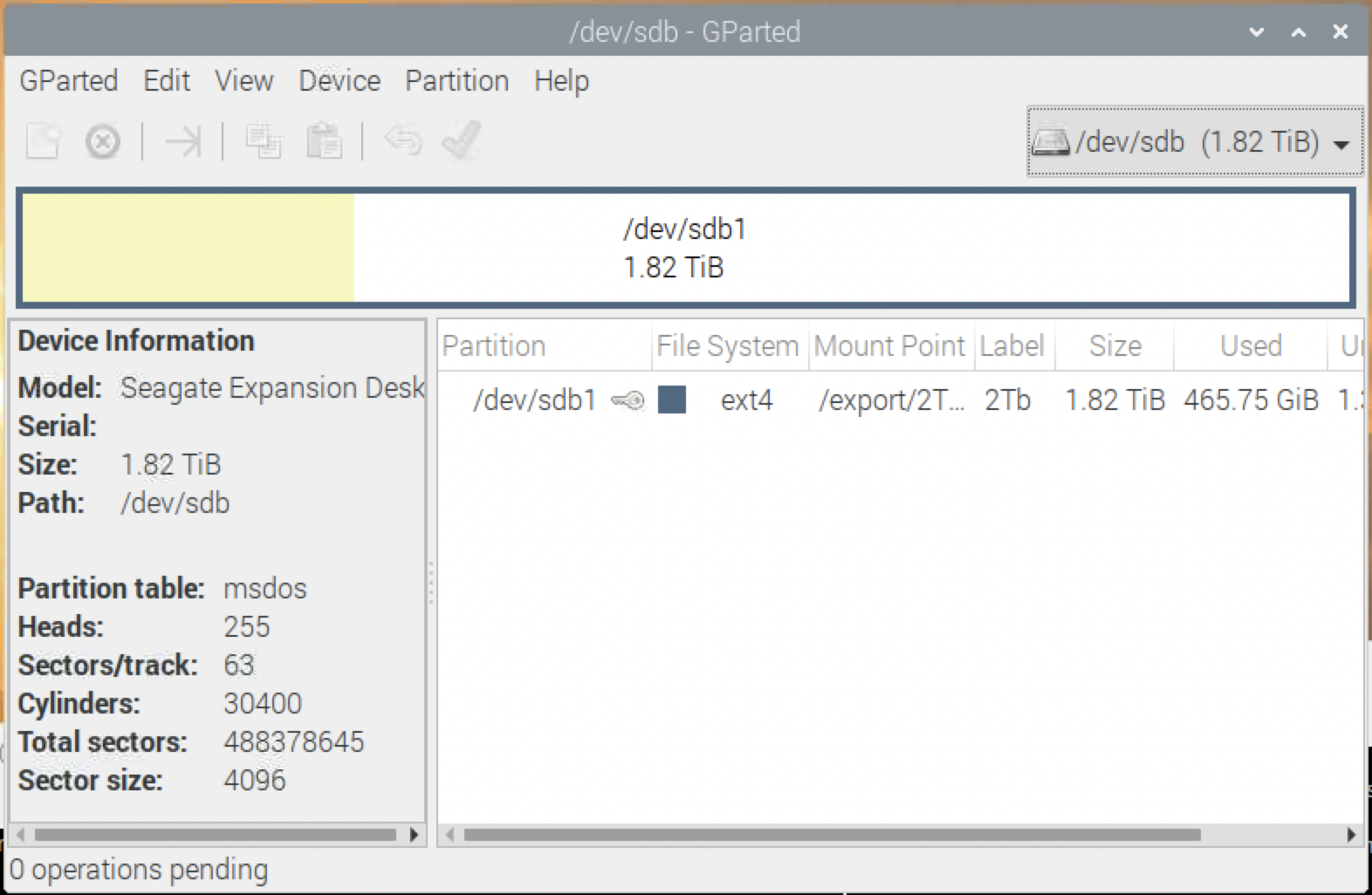

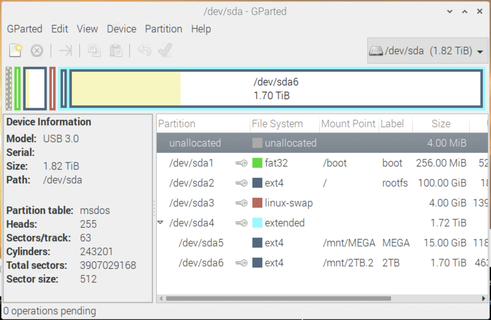

You can't change the underlying sector size. It is fixed to whatever the manufacturer set up, 512, 1024, 4096, etc.
You just have to check what the sector size is on a drive before you start.
I have wasted days trying to boot from drives with the wrong sector size.
Now I know what to look for I was able to find a drive that had the right sector size and get it going.
Sector size (bottom left hand corner) 512. Was able to boot from.
Sector size 4096. Couldn't get to boot from. Ended up re-formatting and using for storage.

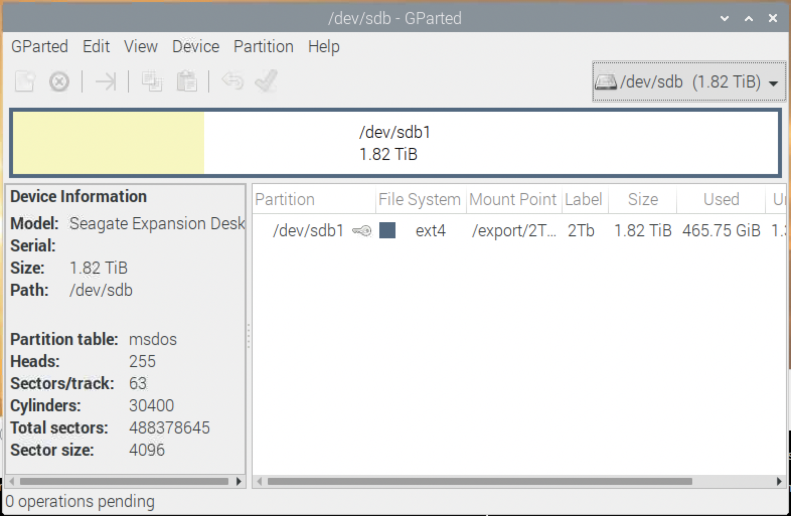

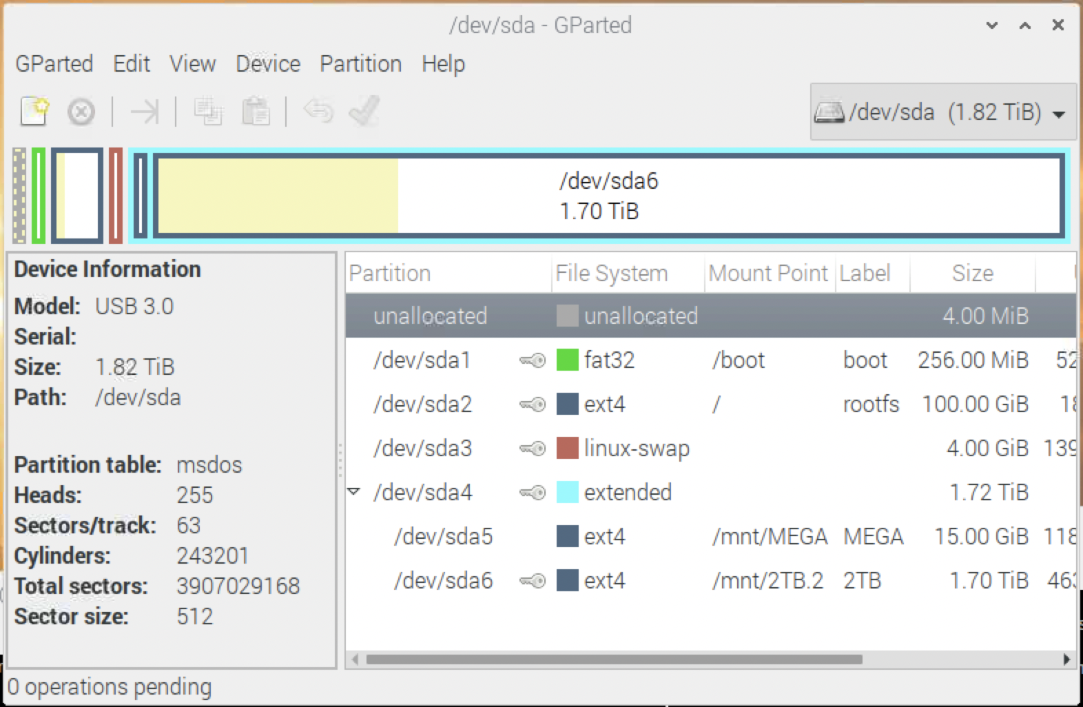

MSector size 4096. Couldn't get to boot from. Ended up re-formatting and using for storage.
