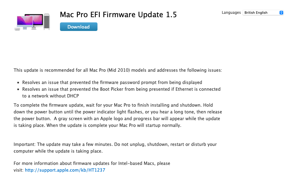

The keyboard that you are using can get the BootPicker with another Mac? Test if you can get the BootPicker with the keyboard with a newer Mac first.
Maybe the problem is the keyboard firmware, years ago Apple sent a firmware update for the Apple Wired Keyboard With Numeric Keys - I don't know if this  keyboard firmware update is still available. The first mid-2010 BootROM update also improved BootPicker compatibility when used connected to some ethernet connected digital sound mixers (the no DHCP network below).

I've tried this firmware update, but it said it's not for my system. Thank you anyway!!
