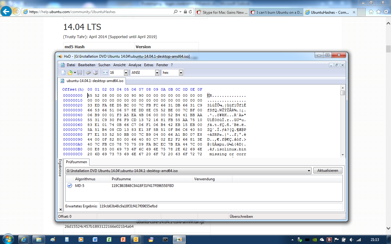

Sorry if this is a lamebrain mistake, but no I didn't. How would I go on about checking the integrity of my ISO?
Here is the checksum you should see for the x64 desktop version - "Erwartetes Ergebnis" at the bottom of the active window.
