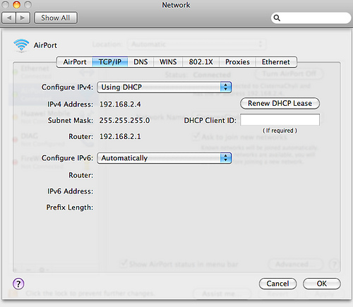

First make sure you're connected to the airport, than go to your Network Setting in System Perf, look at Airport and either take a screenshot or write down the info you see. Go to Advanced and tell us the information in TCP/IP and DNS tabs, you can ignore the rest of the tabs.

Go to System Preferences > Network > Airport > Advanced >TCP/IP and verify that "Using DHCP" is selected (see screencap below). It sounds like you may have inadvertently put a static IP in.

ive selected "Using DHCP"...everything looks ok and it doesnt seem like ive put in a Static IP..., here is what my computer is displaying:
