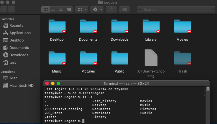

Or make another admin user, log into the new account and try to delete from there.
Good suggestions, except you cannot see the .Trash folder from another user account - it is not a “permanent” folder.
Sure you can see it, you can even delete it from Finder. Here is the admin user test looking at another user's files.
OK - so I can see it, but I can't delete it from Finder (I do not have access), and I can't do it from Terminal either...
