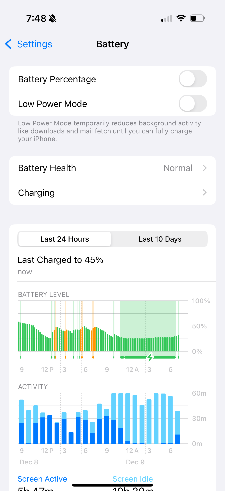

Screenshot pasted below.
This is pretty consistent. Here's what happens. I have low battery in the evening, and I plug the iPhone in. In this case, it was actually on a MagSafe charger. I wake up in the morning, and the battery is still super low. I have no idea why. Then if I pick the phone up and charge it anywhere else at any point during the day, it will charge to full. I do NOT have optimized charging turned on. Why is it only charging to 45%? I'd appreciate any insight and help here. Thanks!

I had the same guess, but that same charger works during the day LOL. I guess you're right, though, I should probably try a different charger tonight for the same period and see what happens.
