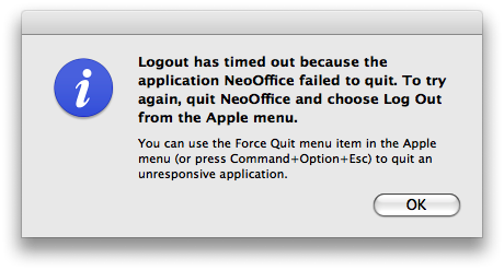

Every time I try and log out of my account on my Macbook (and just mine- it doesn't happen to my family members), I get this error message (attached image) only with a variety of programs (Firefox, iTunes, Quicksilver, iPhoto, and NeoOffice, just to name a few).
When I try and "force quit" the program, it's not an option as the program isn't running.
If I try and logout again, it just happens with another program.
There's also a nice lag from when I first try to log out to when the error message pops up- maybe 5 minutes.

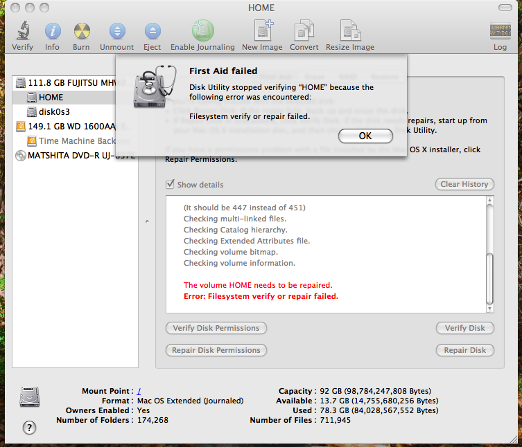

Nope, no new drivers or extensions. Only thing I changed was that I am now allowing fast user switching, or whatever it's called. Going to try verifying the disk now.
Restart holding down Command & S
At the prompt type:
fsck -fy (and press return)
when the disk is fixed type:
reboot (and press return)
At the prompt type:
