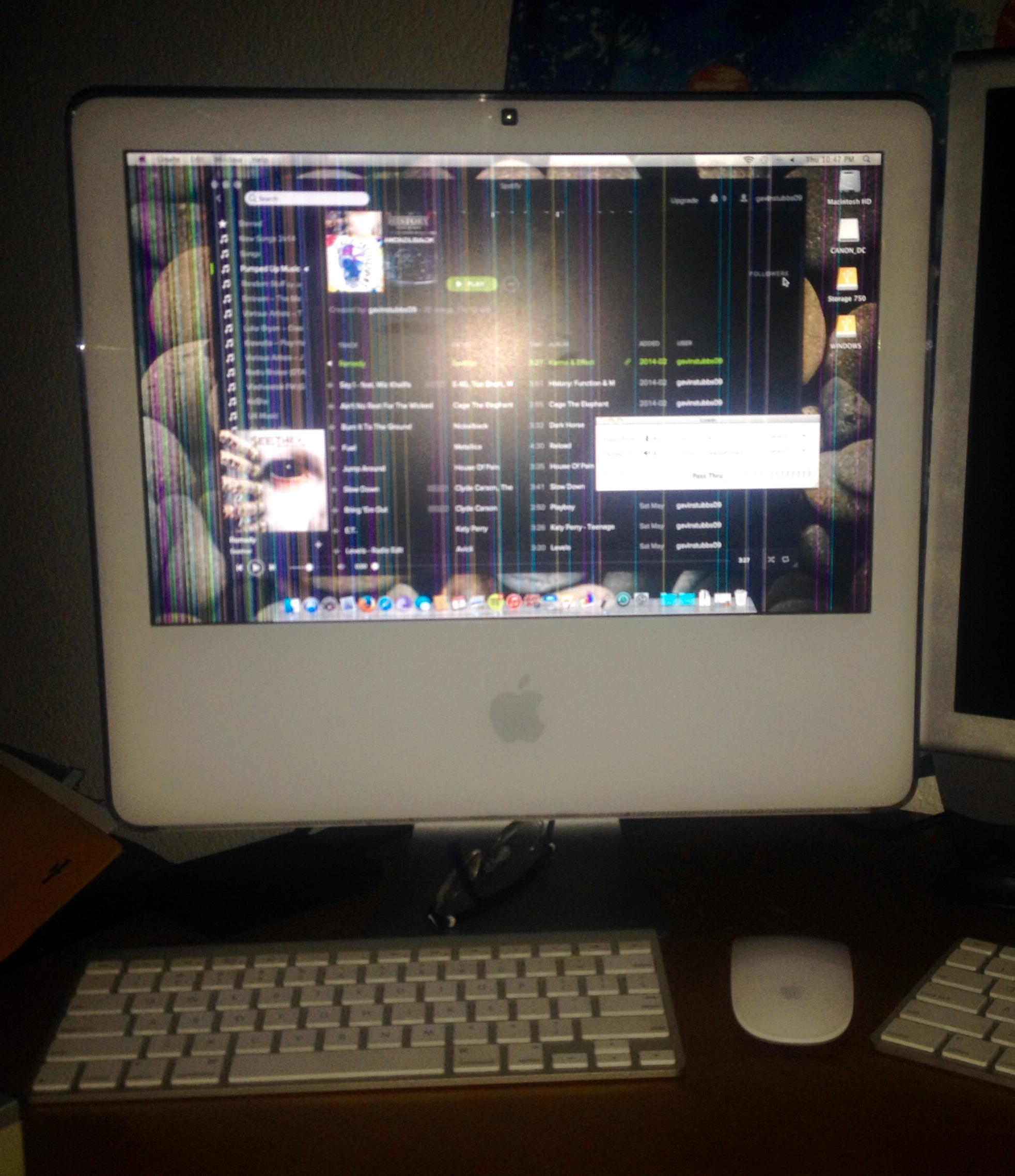

While I hadn't had the time to peek into a recently obtained Imac G4 15", I couldn't resist this 17" G5, which has a flaw on its TFT, which was bundled with a semi-operated twin of its kind, both for US30.00.

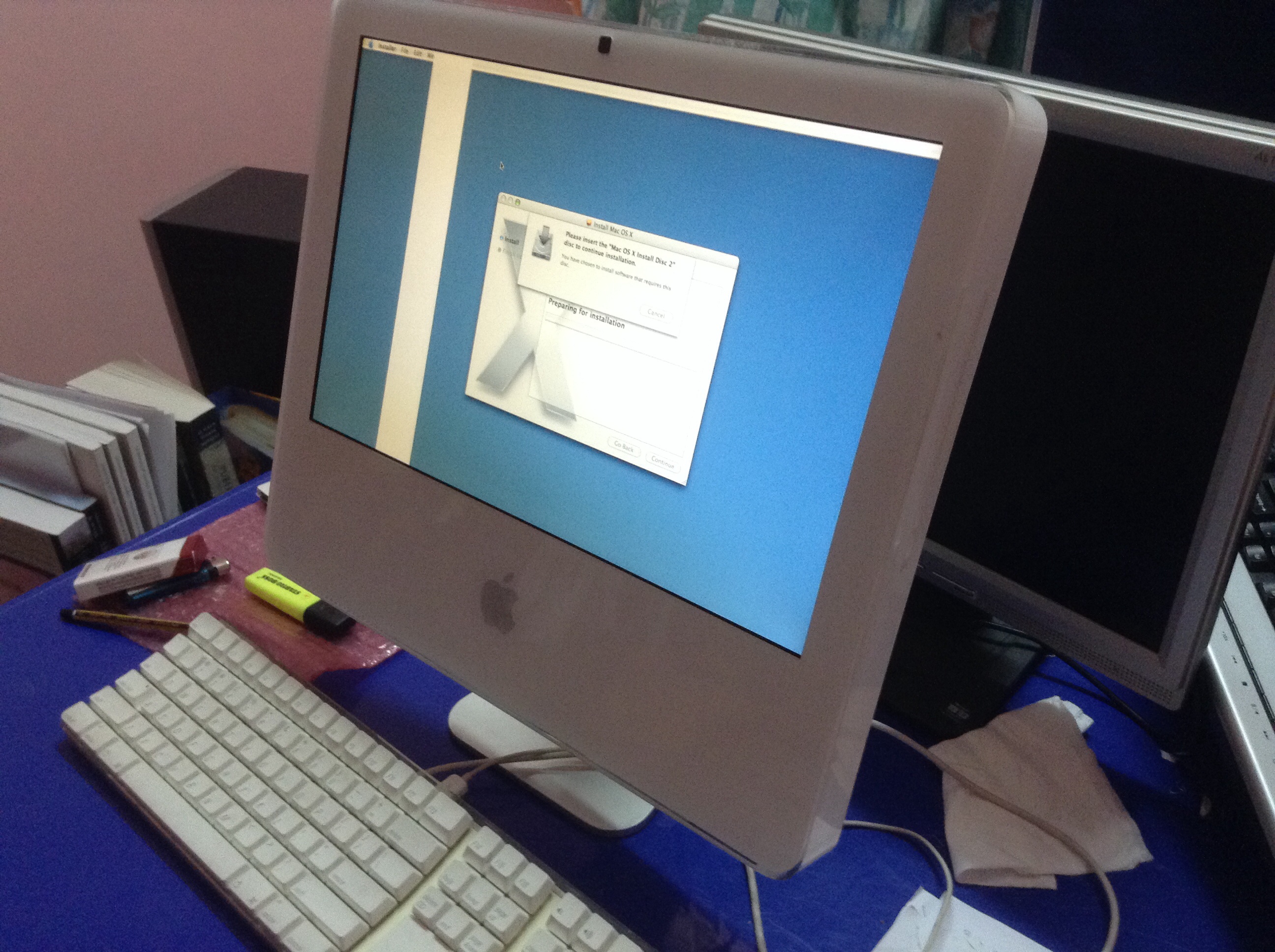

It came in a status which an OS X was halfway installed and is now demanding for the 2nd disc to be inserted!
I inserted a Disc 1 of 10.3, also tried disc 2, both did not seem to get the process running.
I checked EveryMac and it stated that for this model, 10.4 was preinstalled. I then tried a copy of 10.5, which had taken me to the installer screen. But I dnt want to install 10.5.
I would like to install 10.3 or 10.4... I dnt have the 10.4 in a disc yet, I tried to give it a run via USB ...it ddnt work.
What I wish to know is, whether this G5 which came with 10.4 preinstalled, will and would be able to run 10.3..... Cheers.

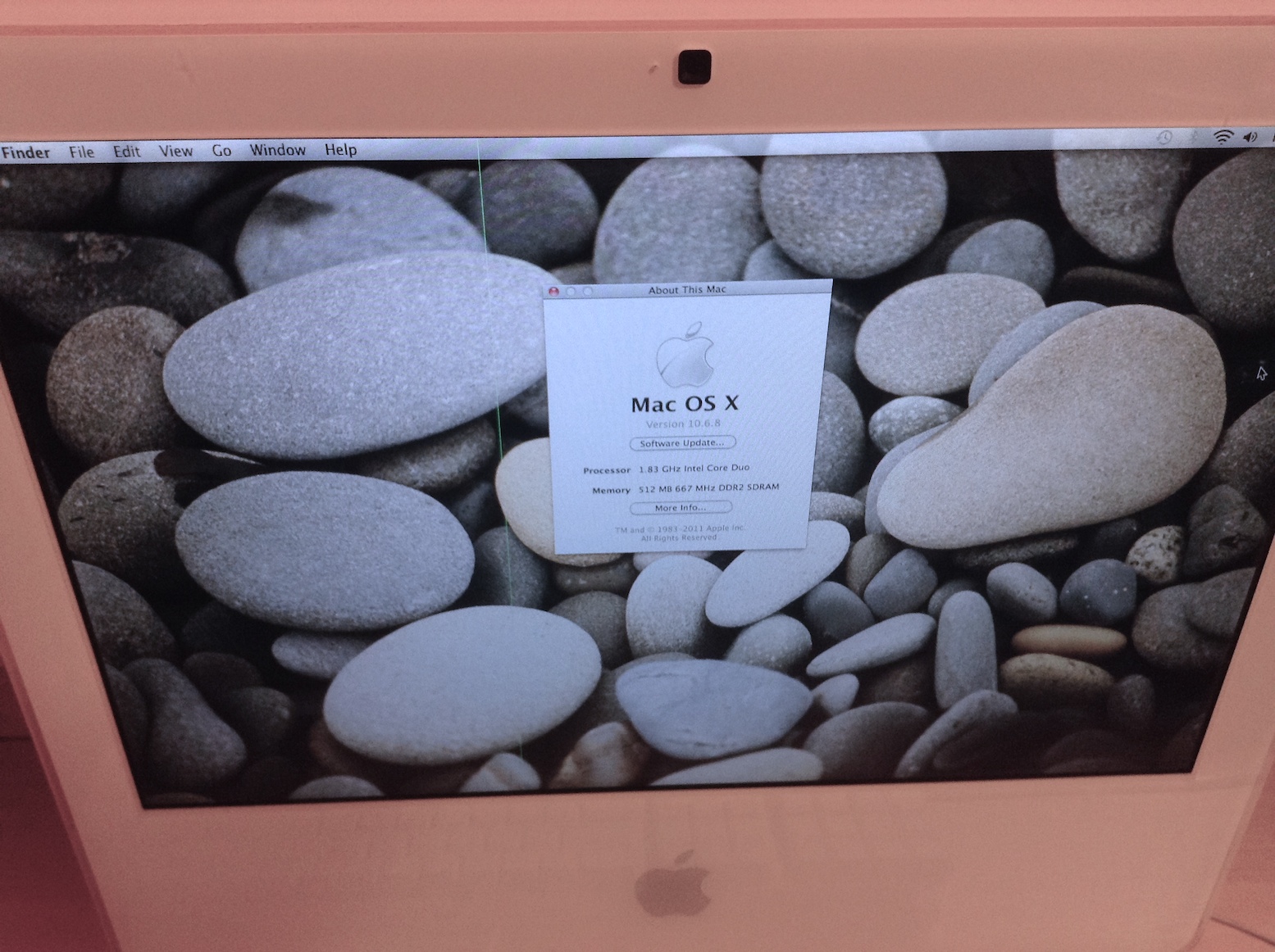

I know it's kinda cheating on the PPC subforum, but I scored this first gen intel iMac for $30 free shipping off ebay a week or so ago. Plans in the future is a Core 2 Duo swap and a new LCD (if I can find one sub-$120). Works great with SL!
Anywho, that is a iSight iMac G5 you have, and Tiger or Leopard are your only choices. Panther is out of the question unless you have the first rev. from 2004. Why not Tiger on the iMac G4 and Leopard on the G5?

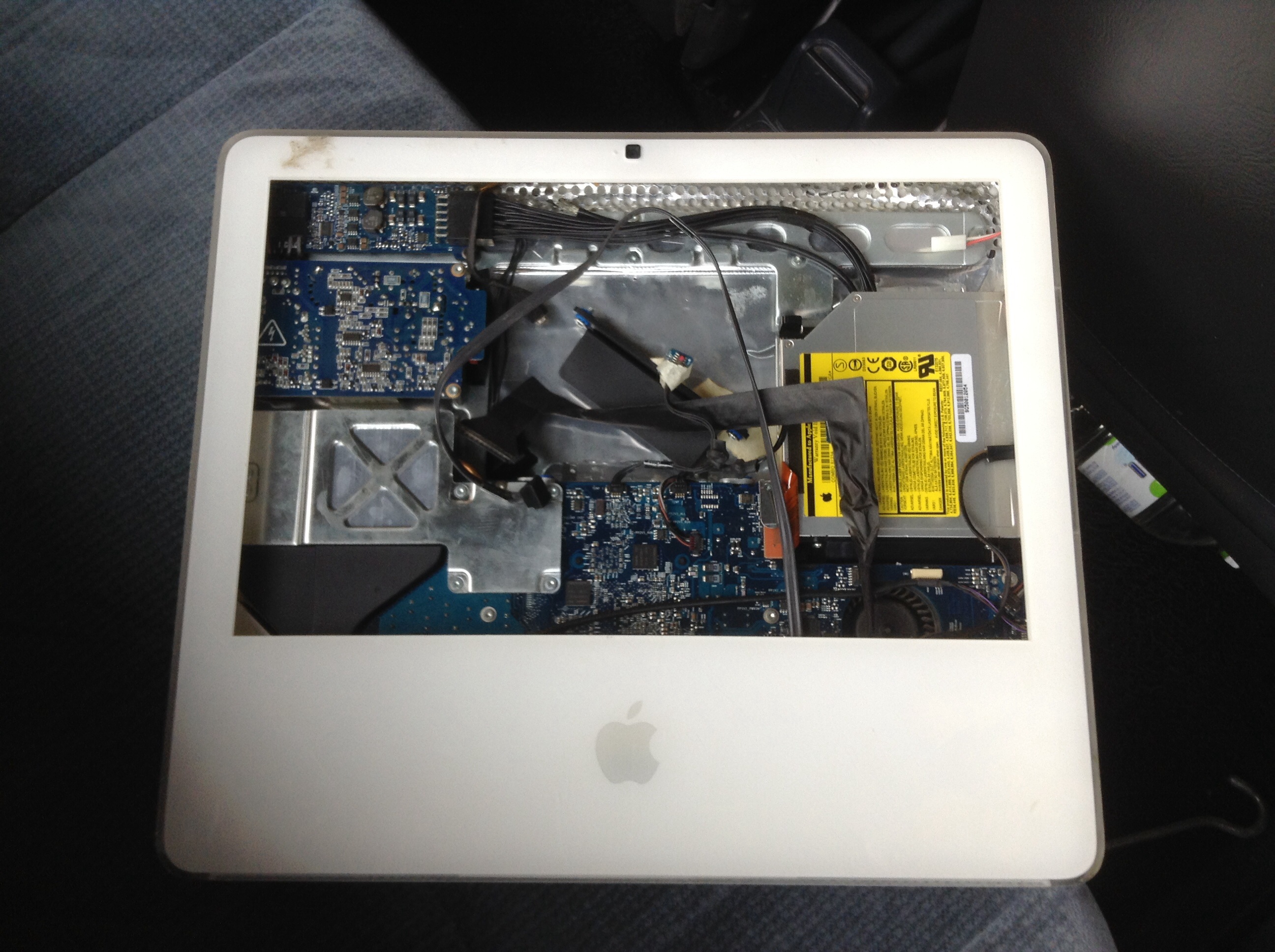

Getting the LCD would be the task now. True, that is an iSight Mac and I have a spare of most of the parts, hopefully the parts are functioning.

We had a 1.9 iSight iMac that had its screen go useless over time with lines. A friends one died from bad onboard ram so I swapped the screens over and now have one working again 😀 :apple: Only thing not working is the iSight camera but hey better than nothing :apple:

The iSight G5 wants a minimum of 10.4.2 so a stock 10.4 disk won't work.
It should be able to install from USB, I would think. Just restore Tiger to a usb stick. Insert the stick, boot to Open Firmware and type
boot ud:,\\:tbxi

Oh dear, true enough.... now i remember looking at the specs at EveryMac. This G5 comes preinstalled with 10.4.2, darn, no wonder it spat out the 10.4 disc, i thought there was an error while burning the disc.
However, that being the case, i had a couple of hours ago installed 10.5 and its running smoothly. Hmm, any idea on as to how do i get 10.4.2 installed..
Can i install 10.4 in my Power Mac G4, push it to 10.4.2 and then clone the 10.4.2 to the HDD in my Imac G5. Target disc mode or something !
I know that my P/Mac G4 will be able to run 10.4 coz i am running it with a triple boot of Panther, Leopard and OS 9.

You could Target Disk Mode install 10.4 then run the combo updater for PPC from another Mac onto the iMac while still in Target Disk Mode.

You have a few options. Have a search on eBay for the Install Disk Media set that came with your iMac model or look for a later retail copy of Tiger. 10.4.0 was just the first version. It got reissued a couple of times with updates.
Alternatively, make your own updated installer using Apple's System Image Utility within Apple's Server Admin Tools
