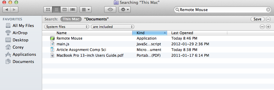

My finder was a little different than the one in the tutorial you linked. There was no contents or file name option, but I did the rest.
As you can see, the first in the list is the App I do not want; Remote Mouse.
The other three files are unrelated.

The pic was attached! It even shows up on my computer. If you don't see it, here is a direct link:
https://forums.macrumors.com/attachment.php?attachmentid=335038&stc=1&d=1334019091
wait, now it's showing as the attachment doesn't exist. Ill re-upload.
https://forums.macrumors.com/attachment.php?attachmentid=335040&stc=1&d=1334019427.png
Part of your problem MAY be that the application is being stored in your Documents folder. If nothing else works, try dragging the app into the Applications folder and THEN do the standard (or otherwise) deletion.
This is the simple method, normally it does suffice to delete an application from the Applications folder (Launchpad is only a visual presentation of installed applications).
GGJstudios did post a simple and effective guide to get rid of all app related data, which the very short article you linked to after more than a year of this thread being last written in did not even touch the slightest, but then again, welcome new member, you will probably not return anyway.
Where does it say anything about the app being stored in the Documents folder? The search just started there, nothing more. And to delete an application via the methods posted by GGJstudios, it does not matter where the application is stored, as the search method includes the entire volume the OS is installed onto.
