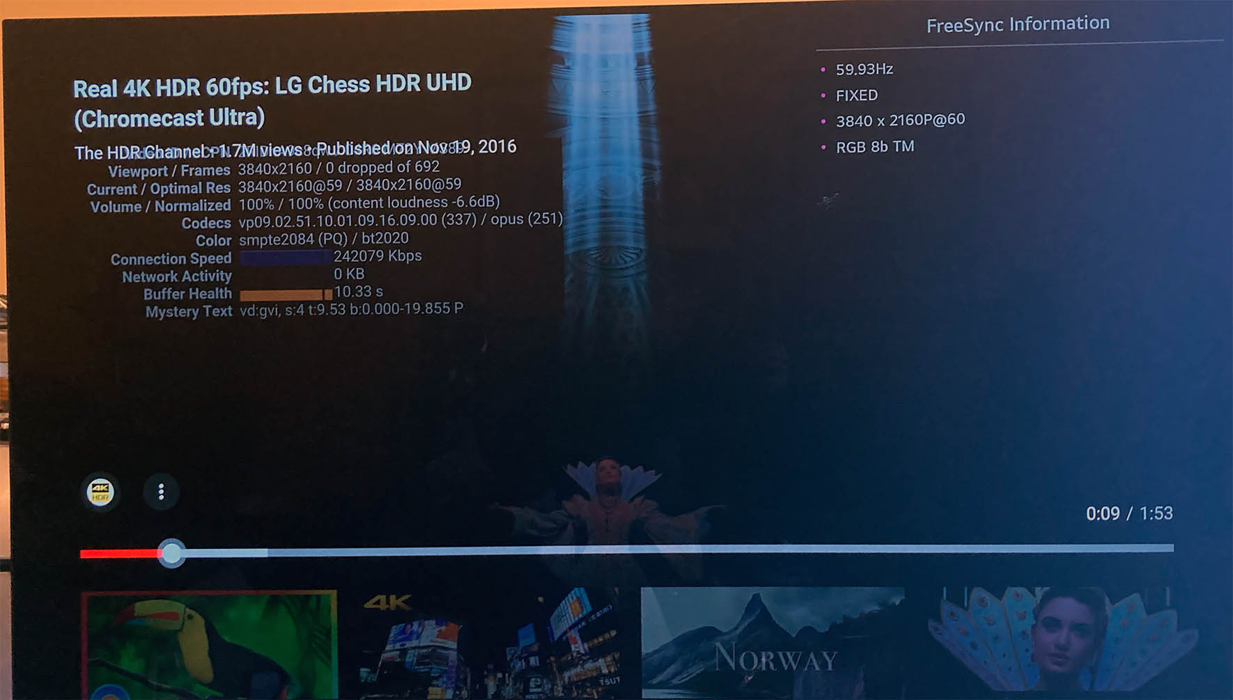

Here is a photo with the YT app and tvOS 14.6 on an ATV 4K 2021. The GUI is set to 4K SDR with full-range RGB output.
Dynamic range matching is enabled but since the YT app doesn't support it it doesn't matter - note your "SMPTE 2084 PQ evidence". Just because a video file is proper HDR doesn't mean the player software (YT app) is decoding and sending it out properly. The only "HDR" you are currently seeing with the YT app is fake HDR applied after the fact by the ATV GUI software that has nothing to do with the original HDR content!

It shows and proves the exact opposite.
- Some people seem to think that just because the YouTube app lists "SMPTE 2084 PQ" in its details that they are getting real HDR;
- The RGB in the FreeSync details proves that the ATV itself is only outputting an SDR signal since currently it cannot output HDR with RGB, even then the YT app is showing its little SMPTE 2084 PQ note;
- The ATV GUI is sitting on top of everything and applys its "HDR" (cranking up colors and brightness "by chance") to anything if its HDMI output is set to 4K HDR;
This is nothing but an assumption on your part. Once again without measurements there is no way to prove whether the AppleTV is applying "fake" HDR on top of a SDR video from youtube, or whether it is passing the HDR video thru.
And I don't want to add to the assumptions but it would seem silly to have a HDR file be stripped of HDR and then add fake HDR on top of it. It would be much easier to just play the original HDR file as is. But we've seen lots of silly things from AppleTV so again I don't want to make assumptions. I'll wait until someone has definitive proof.
If you cannot accept an LG status display showing an HDMI input signal not being HDR since the ATV cannot even output an RGB HDR signal at all (!) then I honestly think that you are just trolling and I fell for it.
