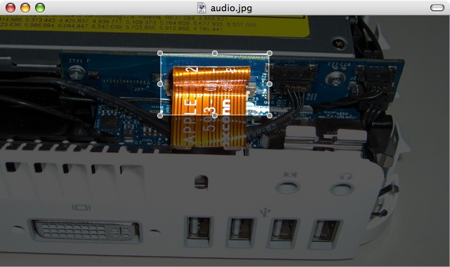

Okay, here's the deal. I opened up my mini to clean out all the dust from the fan, and other places when i accidentaly managed to rip out the red cable that goes from the dvd-player to some controller card on the mini from it's connector on the mini.
It's the red cable on this picture..

but then i worked out what red cable you ripped out , the ribbon -
Did you rip the ribbon cable from the drive end or the end that is attached to the board? It is most likely the cable got detached from the drive end and it's just a matter of reinserting the cable and locking it in place.
You mean like with something sticky? there should be a connector on that end of the cable, but that still is on the back of the drive. I'm no good at soldering and stuff..
Anyone know if the cable is soldered on the board end of the cable (i haven't dared to check)? if it's not, i think it's just a matter of getting a new cable.
It just slides in. No need to solder it back together. I did the same thing to mine but I removed it on purpose when I was upgrading the memory.
It took a little work, but hey, it's back together and it works 😀
